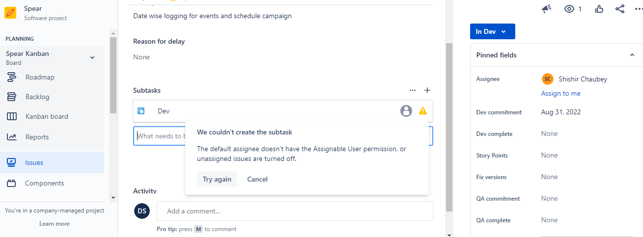

Being a team member in a project, not able to create a subtask in any story in jira project.
Being the Administrator of the project ,not able to create any sub task or Task in the project. sharing the SS down below.
Error message which I'm getting is
Could you please help in resolving it?
Thanks in Advance.
Hello @Deepika singh,
please refer to Error when creating subtask: "We couldn't create the subtask." | Jira | Atlassian Documentation
"Should you see this response, as an administrator, check the project settings:
If the 'Default Assignee' is not a valid assignable user, the sub-task will not be able to be created. In this case, update the project settings to either 'Unassigned' or to a valid user and then 'Save'. This should address to error and allow you to create Subtasks as normal."
Cheers,
Lars
