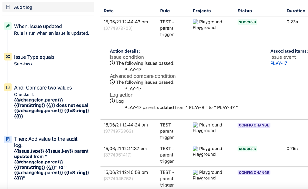

@Lenny Tabakman - Please see the below response from @Mykenna Cepek
She has added a screenshot of the automation rule. That's what I was suggesting.

The following test rule worked as a workaround. A downside is that the rule will trigger for every issue edit (important if you are on a plan with limited number of rule executions).

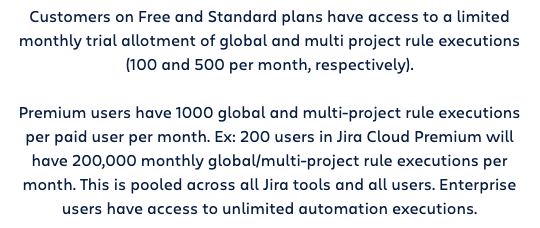

It's not easy to find a complete list of Automation limitations, so here they are:
  • Automation Service Limits (not a complete list!)
  • Automation limits by Jira Plan (scroll down to "Automation" in the first column and click that hyperlink, which shows the screenshot below).
Note that Jira Premium and Enterprise limits should not have to worry about the workaround above impacting any automation limits.

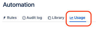

Remember too that you can monitor your automation usage on the main Automation admin page:
