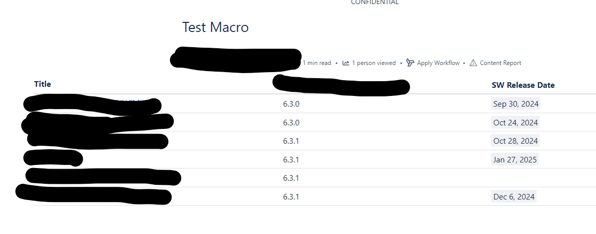

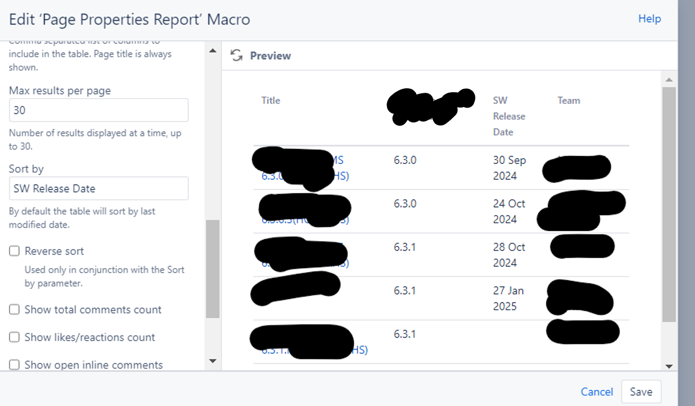

Hi I am using Page Properties Report to display a list of releases we are working on.
From the edit mode I set it as Order By SW Release Date, but it doesn't seem to apply the change as the item Jan 27 appears before Dec 6 2024.
Could someone please help ?

Daisuke Yoshida October 30, 2024
Hi Shawn,
It looks like this. It looks to me that if there SW Release Date is left blank then the order is not as expected.
Like Humashankar VJ likes this
Shawn Doyle - ReleaseTEAM
October 30, 2024
I don't see any pattern of the date being sorted in your screenshots.  I agree it looks like if any page has the date blank the sort is being ignored.  I will test this on my instance, you may have found a bug.
