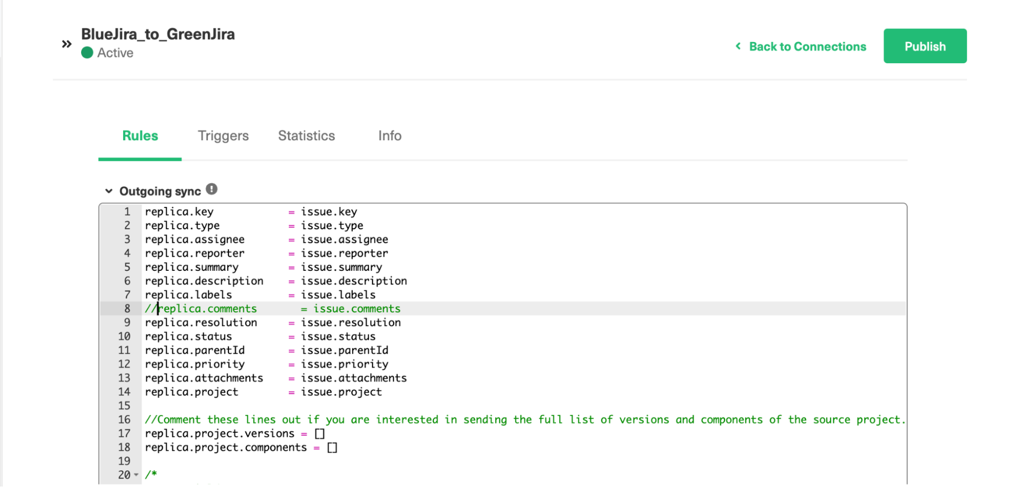

Next, you need to configure the connection. You can do that by clicking the “Configure sync” button after establishing the connection or editing it under the “Connections” tab in the Exalate console.
You can see the “Rules” tab here. This tab is where the Groovy-based scripts we talked about earlier reside. The “Outgoing sync” contains scripts that control what you want to send to the other Jira. The “Incoming sync” contains scripts that decide how you want to interpret the information coming from the destination Jira.
Since we want a bidirectional Tempo worklogs sync between the Jira instances, we must modify both scripts at both ends.
Outgoing Sync
The incoming and outgoing sync scripts will remain the same on JCA and JCB. Only the token must be replaced with the actual token that you’ve generated.
replica.workLogs = issue.workLogs
