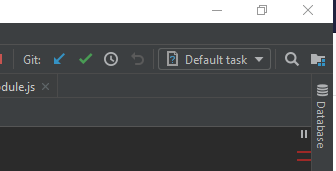

Working: Settings -> Tools -> Tasks -> Servers, I was able to setup a configured server that I can test the connection successfully and results in being able to access tasks in the upper right corner.

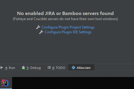

Not Working: Atlassian pane indicates "No enabled JIRA or Bamboo servers found". Clicking on Configure Plugin Project Settings then plus displays a form with similar inputs. I've tried both Add JIRA Server and Connect to JIRA Studio.
