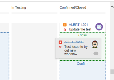

We have a JIRA Agile board in which the final column represents two statuses: "confirmed" or "closed". Mostly, when people drag an issue to this column, they want to transition to "confirmed". However, "closed" is at the top, and so if people are not being careful, they often transition to the wrong status. It would be so much easier to use if we could just put the "confirmed" status at the top. (See wrongorder.png)

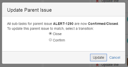

The same issue is seen in the dialog for a parent issue, after clicking the "Move to Confirmed/Closed" button: "Close" is the first choice and is the default. (see wrongorderparent.png)

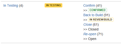

- Within the workflow, the transitions are already in the order we'd like them (see transitionorder.png)
- Within the Ops bar, same-- we control the order with opsbar-sequence. (see opsbarorder.png)

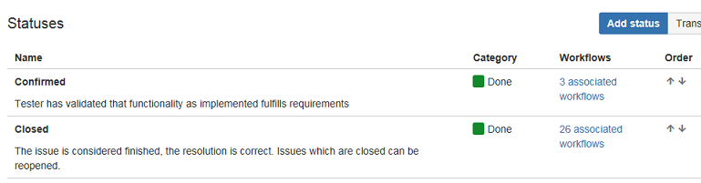

- The statuses are also in the order we'd like (see statusorder.png)
