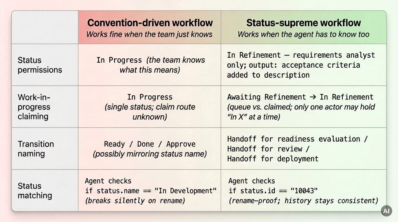

Designing the workflow so P1 can be enforced
A workflow can only be authoritative if it carries enough information to be authoritative. That sounds circular until you look at a real board and see how often the answer to "what does this status mean?" is "the team knows". For agents that isn't a workable answer. So a status-supreme workflow has a few structural properties that a convention-driven (the kind where the team just knows) one doesn't need:
Reckon your workflow is ready to be authoritative? Here's a few things to keep in mind.
Every status has a one-sentence, agent-readable answer to "Who can do what to an item in this status, and how do they know they're allowed to?" If the answer requires a paragraph, the status is doing too much and should be split. The clearest test I know of: can a new team member (or agent) read the status name alone and be right about it more than 80% of the time? If not, the name is misleading and humans are likely filling the gap (or leaping over it).
Claim-based work-in-progress statuses. The distinction between Awaiting X (queue) and In X (claimed, being worked) is not cosmetic; it's the difference between "the work is available" and "the work is happening, by exactly one actor". A workflow without that distinction cannot enforce single-owner claims without side-channels.
Handoff transitions that name the destination, not the action. Handoff for readiness evaluation forces the transition to encode what happens next. Ready — a common human-workflow verb — does not. Name transitions after what happens next, not after how the previous stage ended.
Match on ids, not names: the workflow will trip on its own renames. Agents read history, and history contains every previous name of every renamed status, still fossilised at the point the transition fired. A workflow that expects agents to match by name will discover this the hard way, and 'the hard way' in this context has a change log entry and a PR number.
None of these are exotic. They're what falls out of taking P1 seriously — the workflow has to carry, structurally, the information the agent will otherwise substitute a guess for.
