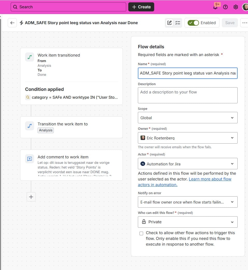

We’re currently using JMWE to ensure that Story Points are filled in when an issue is set to the “Done” status; if this isn’t the case, the issue reverts to its previous status.
I’d now like to achieve this with an automation rule, but I’ve already set up various actions using branches, if-else statements, etc. However, it boils down to having to create a separate rule for each status transition, as shown in the attachment.
So, if the transition is from A to Done and the conditions aren’t met, it reverts to A.
Since the workflow has 10 statuses, I’ve created 10 automation rules.
Is it easy to merge these, or is there another way I could have solved this?
