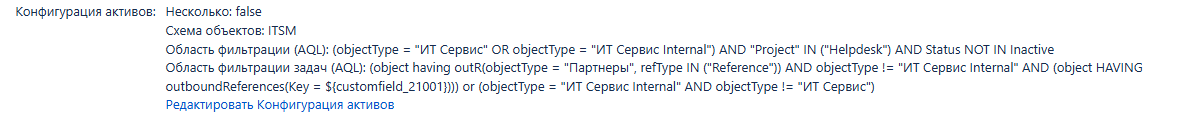

Maybe someone has encountered or worked a lot with assets in Jira, do you have a question about how to configure the relationship between assets fields?
The situation is like this, there are 2 fields, one with Partners and the other with Services, and it is necessary that only their services are displayed for certain partners, and for the rest, or if no Partner is specified at all, the list remains the same.
I have configured links between directories and filtering in the dependent field.
This is not how filtering works, if nothing is specified in the Partner field, it outputs the necessary values, and when we select a Partner, those related to the selected partner are added to the current Services, although only the services of the selected partner should be displayed.
