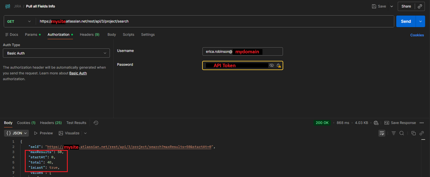

Right now, I'm stuck at the first API call. I've confirmed the call works just fine in postman, I get a list of projects back, no problem. The second API also works, but if I don't include the project ID, I have no way of telling what component belongs where - thus the automation.

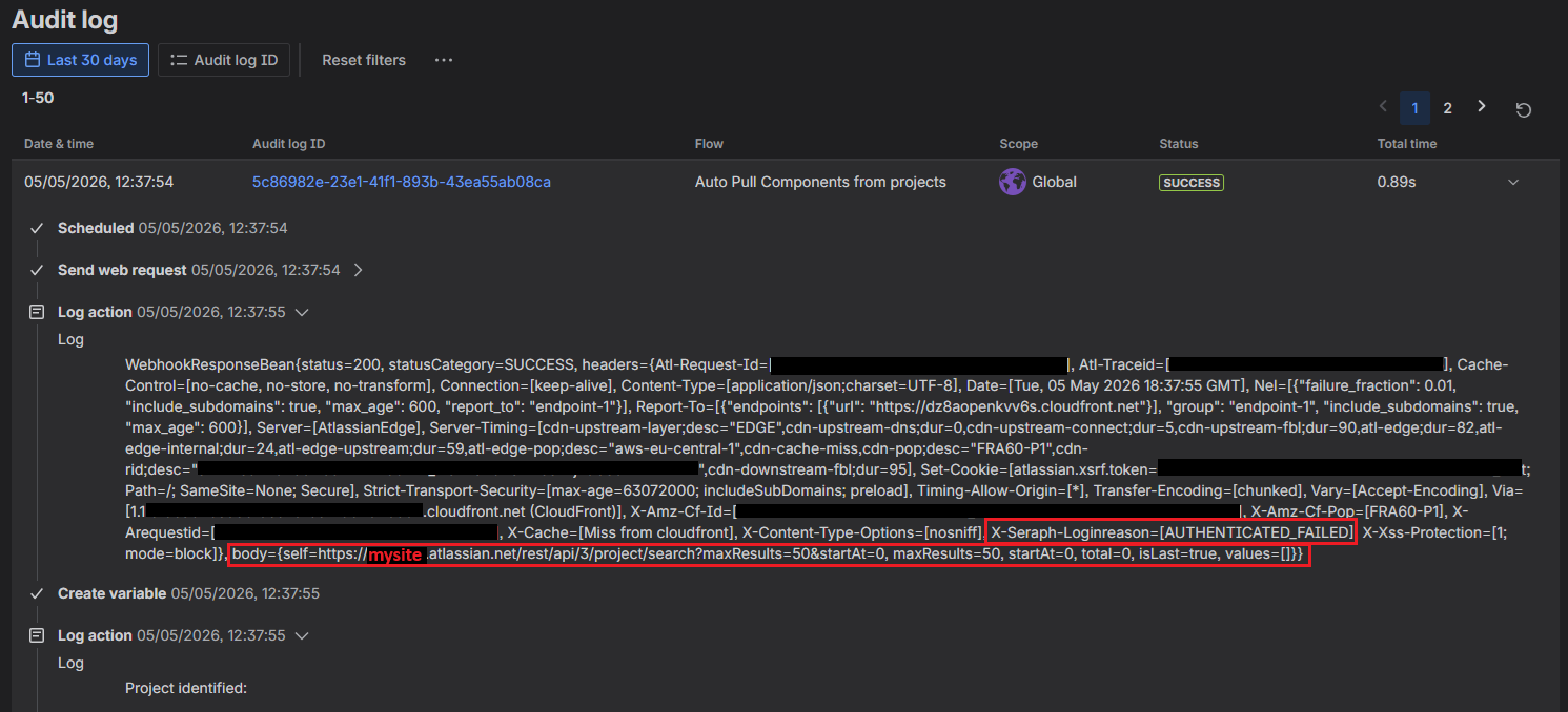

The automation is failing with this error noted in the webhookResponse:
X-Seraph-Loginreason=[AUTHENTICATED_FAILED]

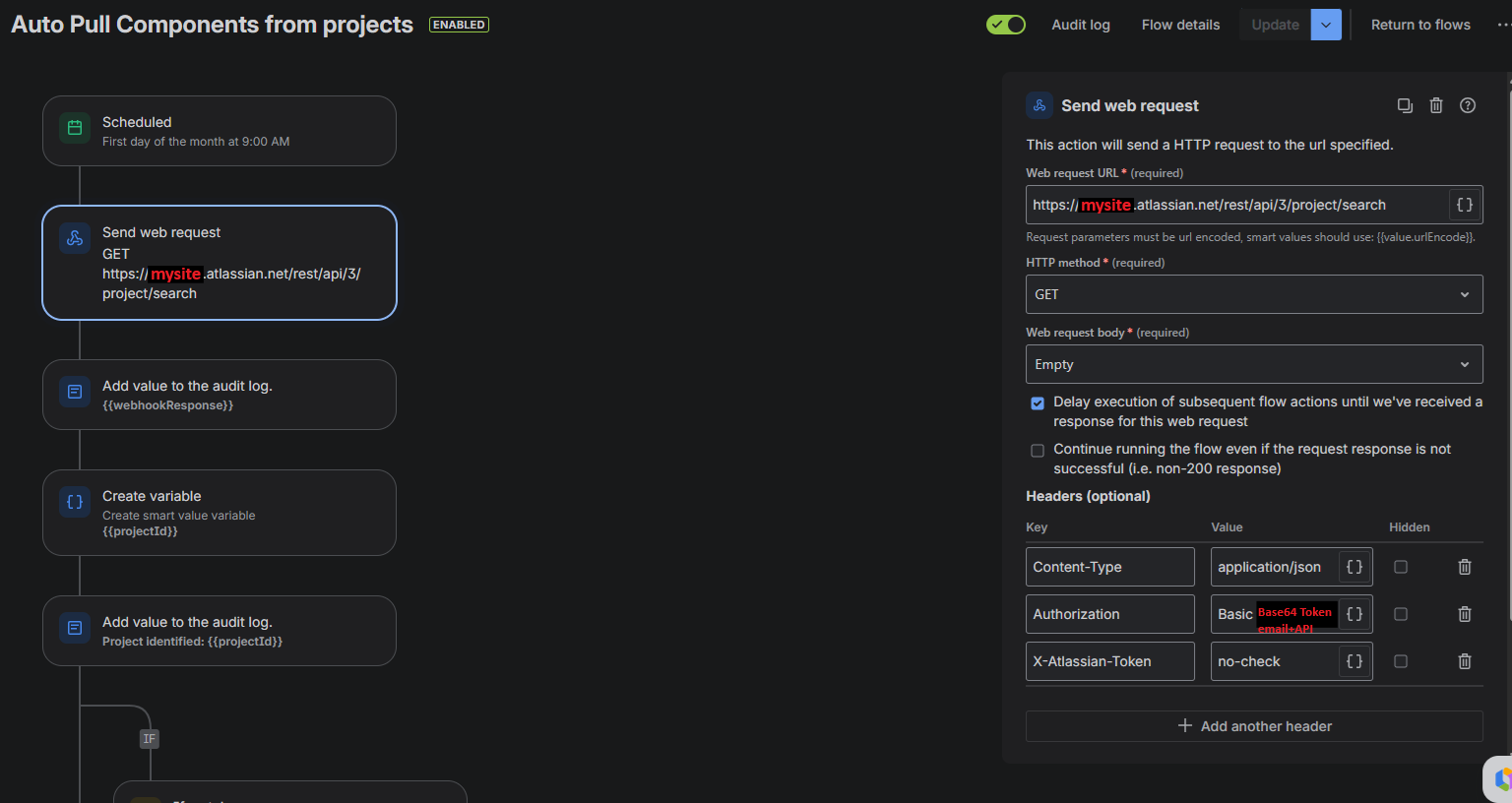

I've tried the following combinations
| Key | Value |
| Authorization | Basic <email>:<API token> |
| Authorization | Basic <email>:<Base64 encoded token - API token only> |
| Authorization | Basic <Base64 encoded token - email + API token> |
| Authorization | Basic <API token> |
| Authorization | <API token> |
| Authorization | <Base64 encoded token - email + API token> |
I've also tried adding in - recommended from the Atlassian AI:
| X-Atlassian-Token | no-check |
None of these modifications have worked or changed the output - other than just failing the test checks immediately vs just in the webhookResponse body.
Here's the piece of the automation that's failing with the audit logs:
Here's the postman call using the basic auth creds:
