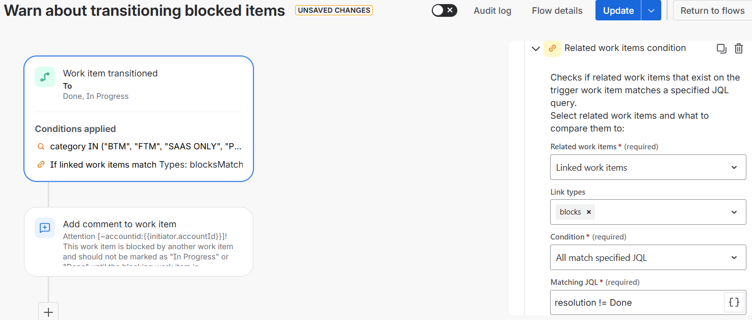

I am looking for a way to have Jira Automation auto-comment on a work item, when it's transitioned to "Done", if it has at least one linked working item of the type "blocking".
Essentially, I want the user to be notified when they are trying to move forward a work item which has pre-conditions, based on the built-in "linked issue" functionality. So far, results have been touch and go with many false positives and negatives.
Here is my setup:
My needed automation logic:
IF
[Work item A] is transitioned to "Done"
AND
[Work item A] has a linked [work item B] blocking it (linked issue: "blocks")
AND
[Work item B] is NOT "Done"
Then
Comment on [Work item A] ("Attention!
This work item is blocked by another work item and should not be marked as "Done" until the blocking work item is completed first.")
