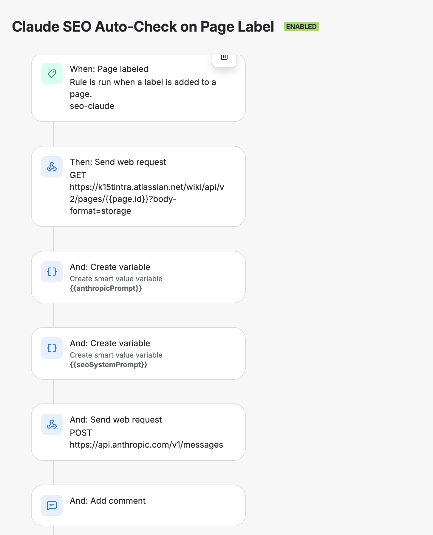

- Someone adds an seo-check label to a Confluence page
- A Confluence automation rule fires and sends the page content to my AI agent via a Send web request action
- The agent runs a full SEO audit against my playbook and posts the result as a page comment

What I ended up doing is moving the system prompt into variables — {{anthropicPrompt}} and {{seoSystemPrompt}} — and keeping the request body as light as possible. That combination gets the request through within the 30-second window.
