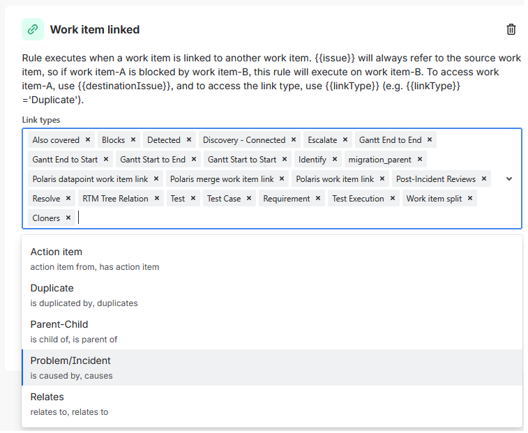

I tried to create a automation which is triggered when a new link is created. As for the user, the list of possibilities is endless. So I tried to grab ALL of the types which should not be used: (why not c&p from clipboard in this editor here? -> inconsistency)
Now comes the first quirk: It's seems NOT possible to refer to the just created link itself, the one which triggered the rule - which is the one I want to simply delete. Am I wrong?

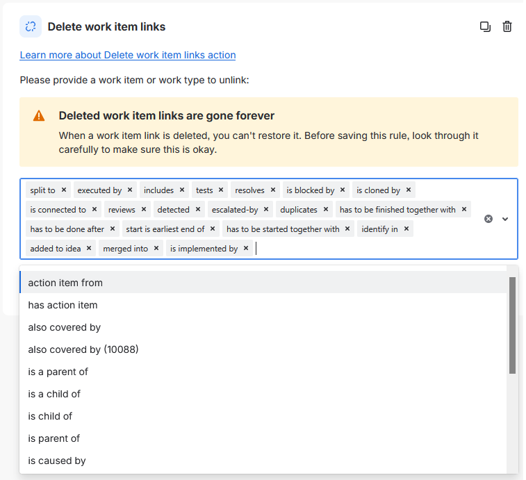

It seems only possible to delete ALL links of a specific type - In my case that could be accepted, but what would you do if you want to just delete this specific created one?
Ok, so let's delete all of a specific type. But there comes the next quirk: The selection list looks very different.
And, only for now, comes the last quirk: While in the trigger you can select "Requirement" there is no such possibility to select "is required" or "required by" or similar. What am I missing?
