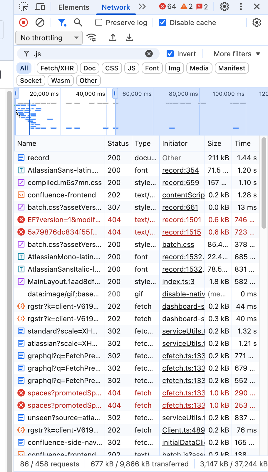

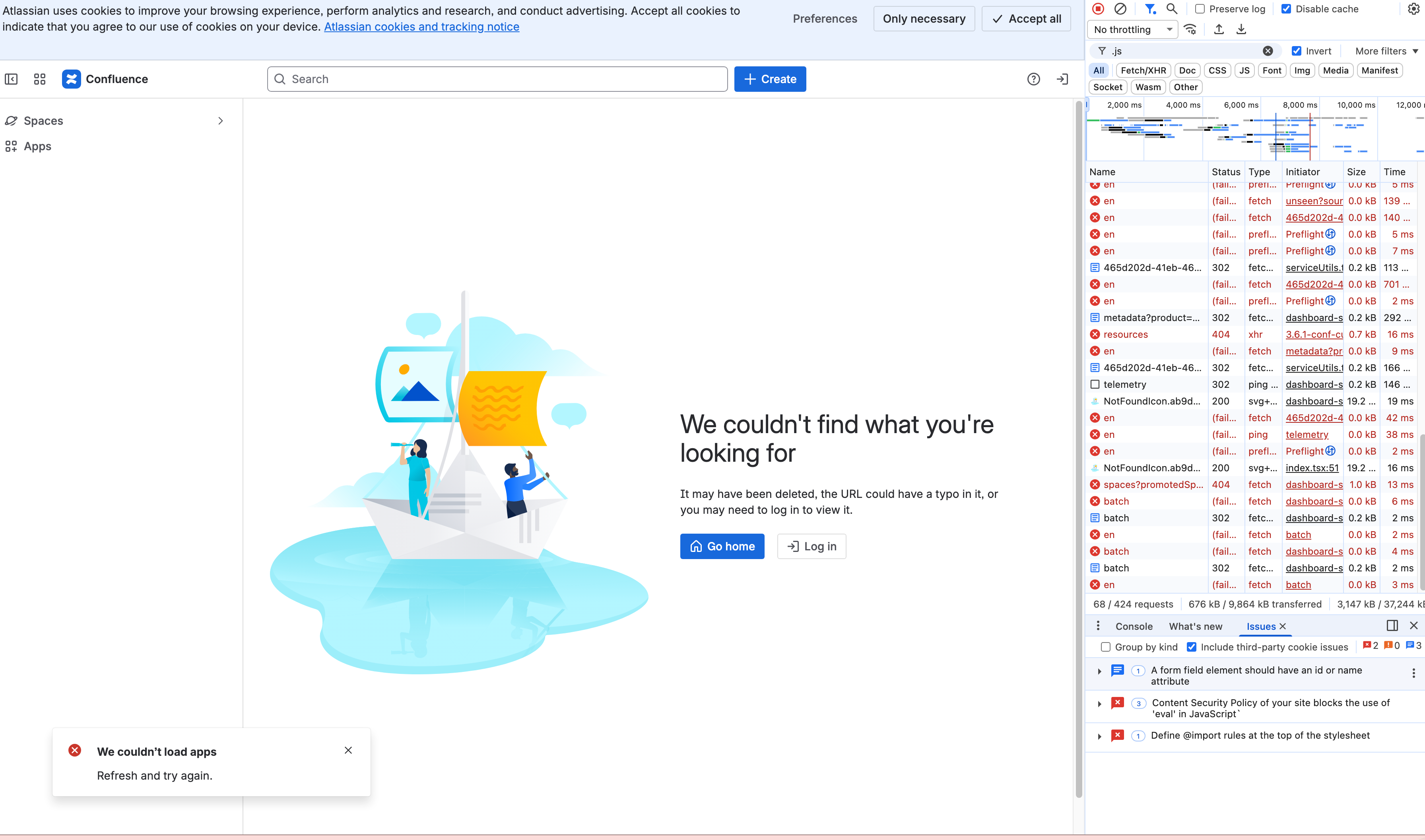

I'm trying to achieve this in one of our Gateway NGinx servers, but with limited success. Testing this on my local machine i can see that the reverse proxy initially works and loads the page with a HTTP 200 OK status - but somewhere in the subsequent flurry of scripts there's some 302 redirects and eventually a 404 Not Found, wiping the page again - see images below (retrieving the page directly works fine, btw).

}I also tried searching the knowledge base here, but no luck so far - I really have no idea where to start looking in that huge stack of 500+ loading events, requests, scripts, etc. to find some indication to what's missing.
