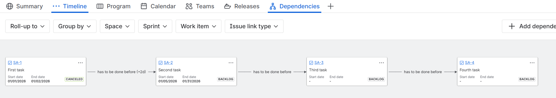

Dependencies are very clear :

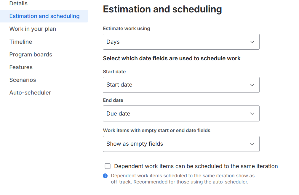

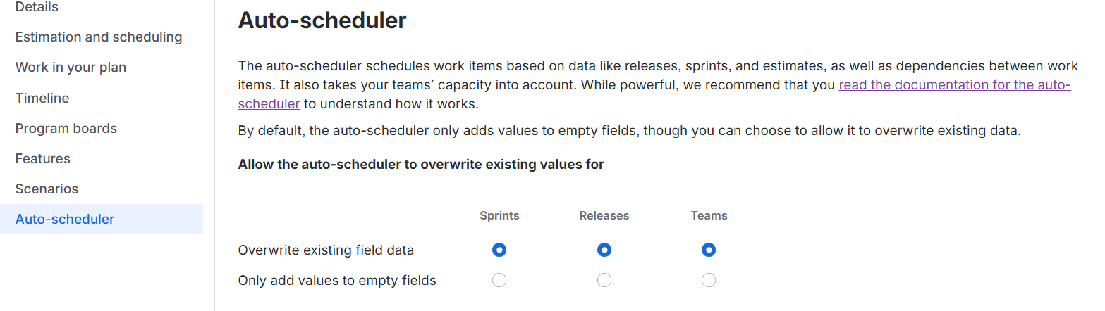

Auto-scheduler is on and can overwrite everything
The fields used are well configured for me

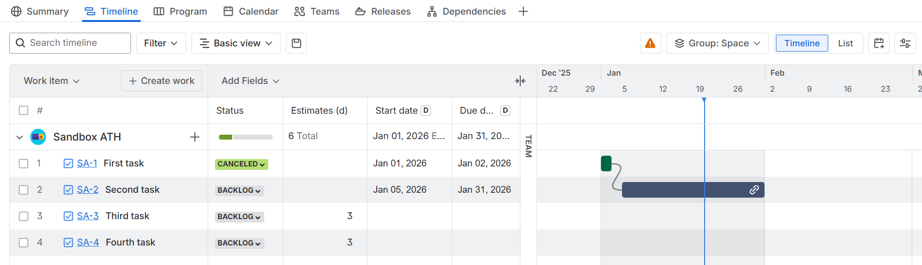

Here is my timeline with Task 1 and 2 fixed dates and 3 and 4 with estimates but no start or end dates
Considering the dependencies, Task 3 should be planned Starting Feb 2 and Task 4 as soon as the third one is done.

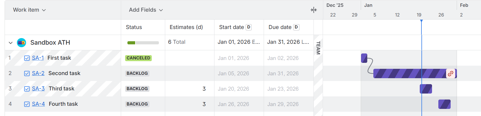

Here is the result I'm having with the auto-schedule :
It does not take into account the dependency between Task 2 and 3. Why does it takes today as the start date of Task 3 instead of Task 2 end date (which is already set manually) ?
