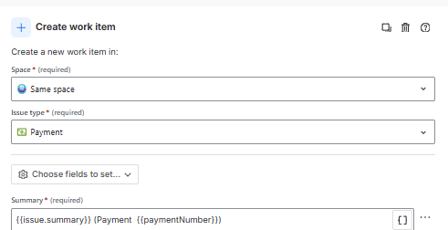

I have a purchase work item (epic - level 1) and based on the number of payments (numeric field) at some point an automation it is triggered to generate the child work items (tasks - level 0) that represent the number of payments. So if the # of payments field is 3, 3 work items will be created with the summary Payment 1, Payment 2 and Payment 3

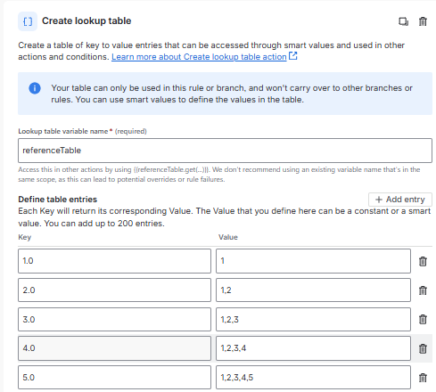

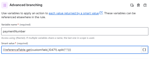

In order to dynamically create the child work items, I'm using a lookup table as suggested here: https://confluence.atlassian.com/automationkb/automation-rule-looping-on-a-numeric-value-in-jira-automation-1416563126.html
and it works well. Creates as many issues as the integer in the field. The problem comes with how Jira seems to handle loops and branches, and the issues are created out of order.
As you can see in this example, the issue summary is created out of order
In this documentation it explains that
Branches on multiple issues (such as 4 sub-tasks) will run in parallel with no guarantee one will finish before the next one starts. Therefore, you cannot rely on changes between branches.

- Trying to rename with a second automation. I was not able to get an index of the loop (like I would do in a programming language) to use in the summary
