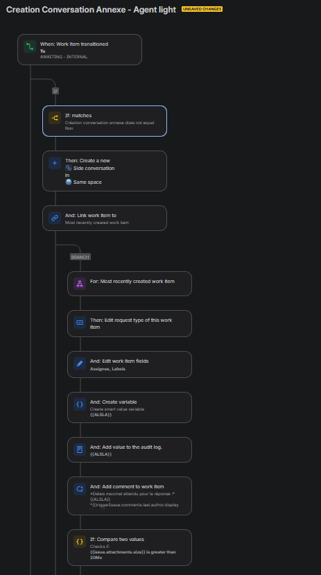

Hi everyone ,
As admin, i'm in charge of finding to make everything work smoothly , on each of ours space.
One existing automation , is to create a linked Issue (A) , and on the created one (B) add a comment (Comment is the "A"last one) + Showing Actual SLA inside the comment in "B"
Would basically look like
Issue A --> Transition trigger automation --> Create Issue B --> Copy last comment of A to B + SLA
We had huge problem with the SLA part as most of the time SLA is still not calculated by the time the automation finish.

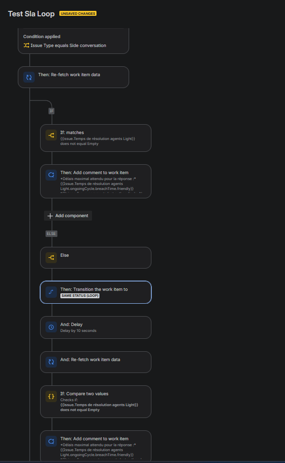

Did few search and make it more reliable by triggering a second automation when the first one have created the second Issue
Second Automation will be in charge to check if value exist , of not to loop on itself wait 10 sec , fetch and then add comment.
For the SLA Part...Seems for reliable than having it inside first automation.
But for the comment part... I can't retrieve thoses information from the linked issue.
I thought of putting the loop inside the first automation, but as the creation of the issue "B" is already behind an IF/Else , and branching, I can't recreate one on that level
So ...I'm looking for idea and Advice. ;-)
