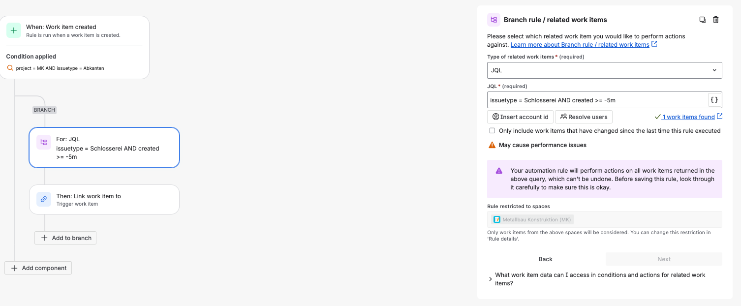

Automation rules number 2-n:
As you can see. The rules finds the correct work item. ("1 work item found"). I checked and it is the correct one.

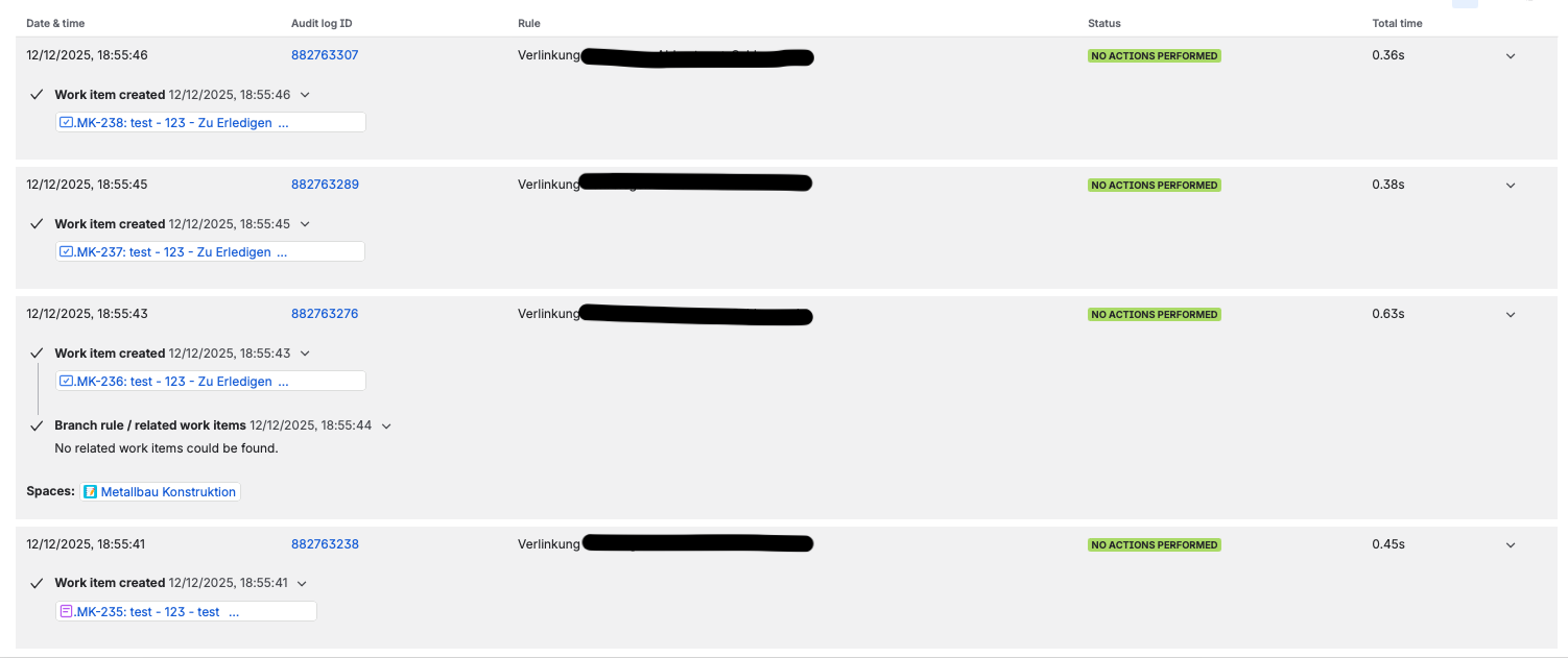

But when I run the rules. This happens:
Because in this case there were 4 process steps, also 4 of the "linking automations" started. But number 3 (first screenshot) that previously found the work item while testing, does not find anything (see audit log => step 3).
So, why is this happening?
Any ideas?
What do I miss?
