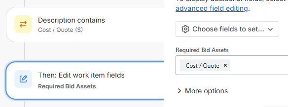

Example from my automation:
It searches the description for the term "Cost / Quote ($)" and if it finds it then is set's the field Required Bid Assets to "Cost / Quote"
These all work individually but not if more than one of these is found.
