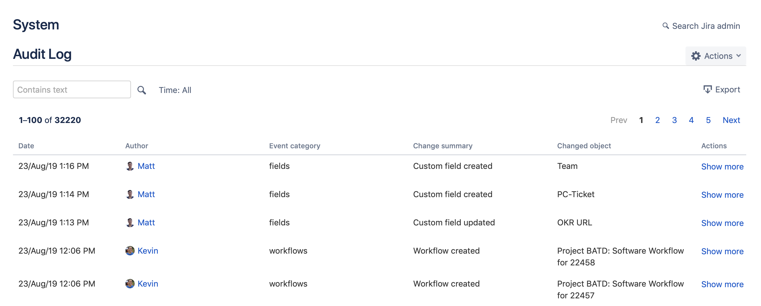

- Audit Log: Jira Settings → System → Audit Log. It displays the configuration and changes made by the admins.
Image source: Atlassian Support

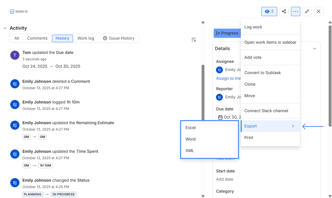

- History Tab: accessible in each work item. It displays changes, such as status updates and comment edits.

- Audit log (admin-level): Go to Settings → System → Audit Log, filter by date, and Export CSV.
- Work item history (user-level): Open the needed work item and go to the History tab to view field changes. To export the work item data, go to Actions and choose Export. Notice that you’ll be able to export the current work item’s field values, not the whole history of changes.Â

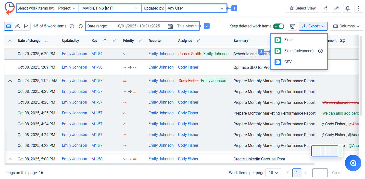

If you need to export full change history of work items, it's better to use an app like Issue History for Jira by SaaSJet.Â
The main benefits of Issue History for Jira app are:

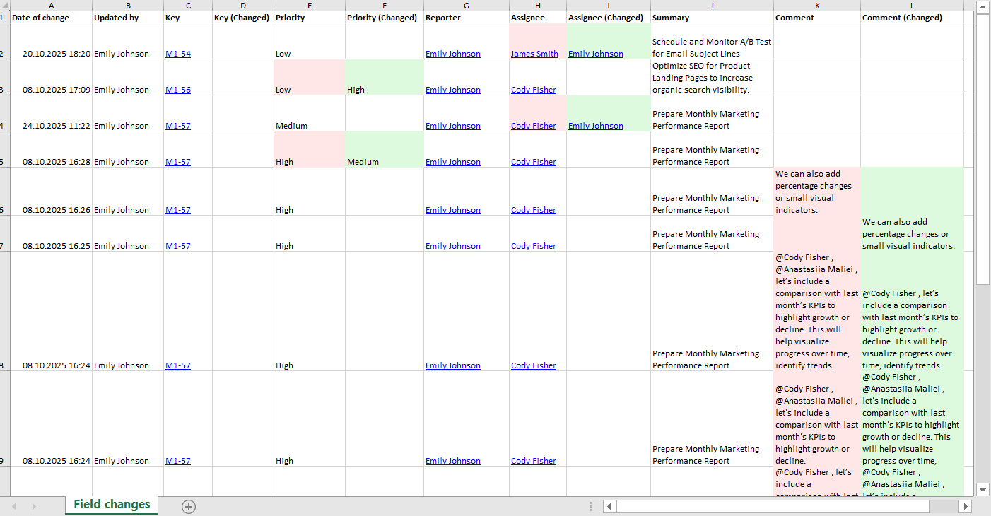

- Export of the full change history of Jira work items. Get the entire history in Excel or CSV in only a few clicks.
- Advanced filters. View history by project, user, sprint, or date range.
- Deleted work items tracking. View the deleted tasks and restore them easily.
- Scalable to audit. Manually export thousands of Jira tasks.
How to start using Issue History for Jira app:
- Install the app from the Atlassian Marketplace and open it from the Apps menu.
- Apply the required filters (project, date range, etc.).
- View a table with all historical changes related to work items.
- Click Export → Excel or CSV.
In just a few steps, you’ll have a complete audit-ready report that you can share with managers, auditors, or stakeholders.
 🔗 Explore all the capabilities of Issue History for Jira app
