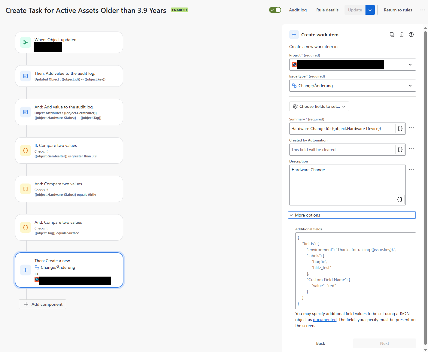

Hello,
I have written a rule that when an asset reaches the device age of 4 years, a work item is created so that we can replace it.
However, certain fields must now be transferred from the asset to the work item. For example, the device age and the serial number of the device.
I have already created a custom asset field (for device age, serial number, etc.) in Jira, but how do I tell the rule that it should be filled in automatically? Do I do that where it says Additional fields?
