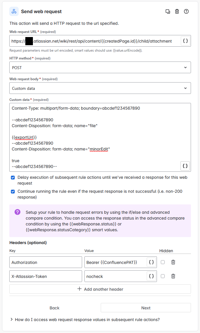

The API request is configured as follows:
I always receive the response HTTP 415 Unsupported Media Type.

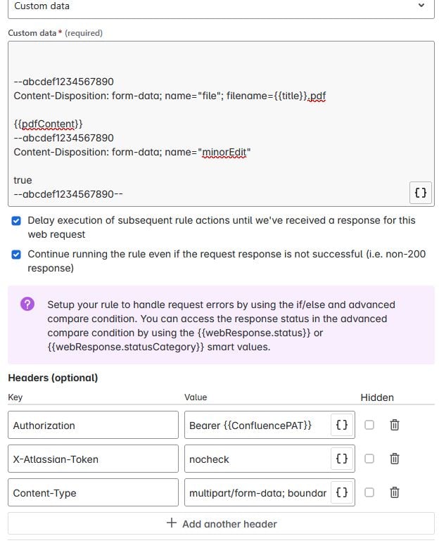

If I migrate Content-Type: multipart/form-data; boundary=... to the Headers then I instead get HTTP 403 Forbidden.
I've also tried retrieving the file using another Web Request and storing the result into a variable, then retrieving that smart value in the body of the request as follows (with and without .urlEncode), unsuccesfully - I have tried with Content-Disposition: application/pdf and application/octet-stream, also without any content type specifier.
