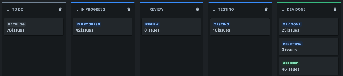

- For development there is a Scrum board with estimation and time tracking enabled as "Original time estimate"

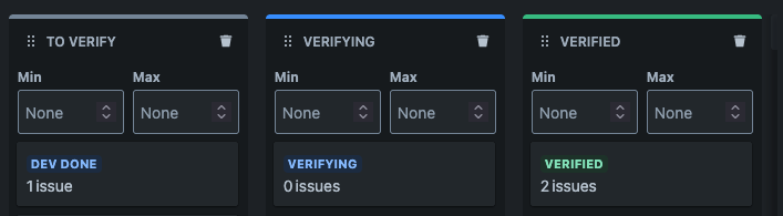

- The right most column in the Board config has "Dev Done", "Verifying" and "Verified" statuses
- For release there is a kanban board, left most column has "Dev Done", middle has "Verifying" and right has "Verified".

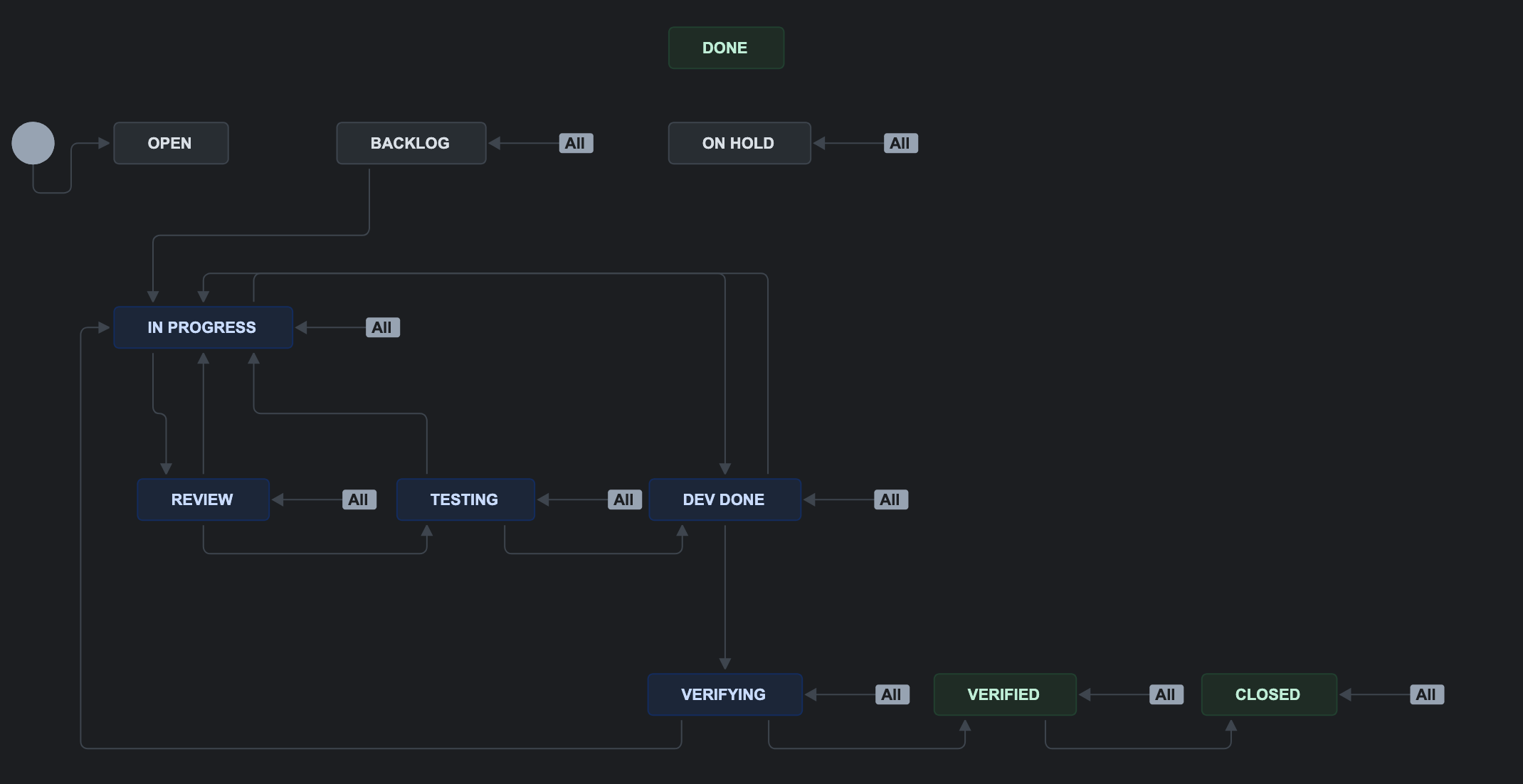

- The last status of the workflow (which combines both development board and release board) is "Closed" this status is not mapped to any columns. Tickets get "Closed" when a Jira Version is Released. I've just added "Closed" to the right most column to see if that helps.

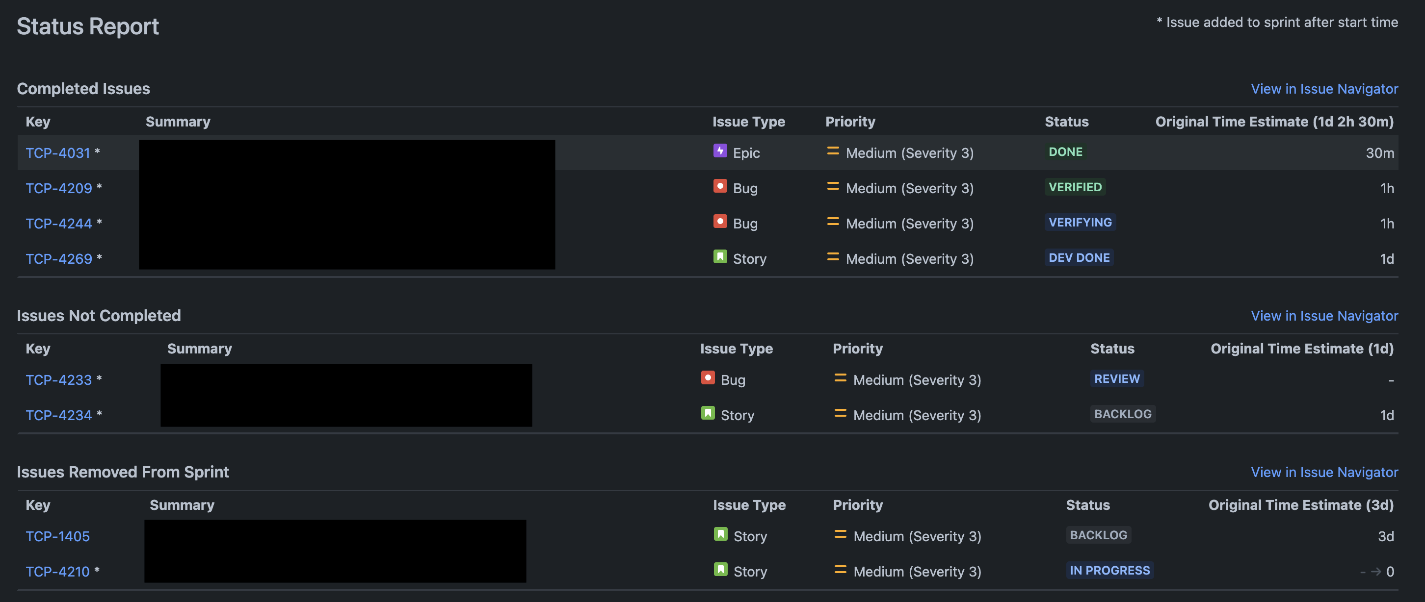

1. The sprint report is completely out. in one case (see attached) the report shows only 8 tickets in the sprint, 7 of them added after the sprint start. However, when searching for the sprint in Issue Navigator, e.g. `sprint = xxx` all issues are represented.

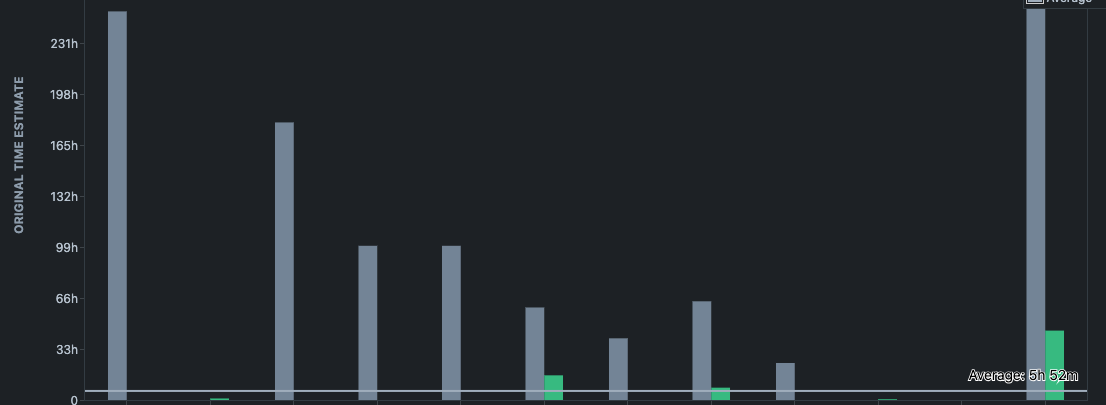

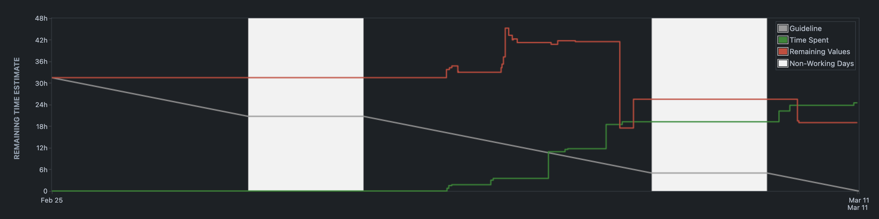

2. The Velocity Chart is out also. Almost no time is being indicated as completed even though time has been tracked correctly in Tempo. Doing an issue search shows Time Spent is being calculated correctly.
