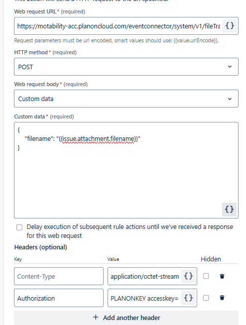

Hi all, looking for some advice regarding attachments to tickets and APIs.
Using automation I'm trying to do a web request call that will send an attachment to an external system using their API where there is and attachment on the JSM ticket. I cant work out what the custom data web request body should look like. i.e. the json syntax
When I add a log using {{issue.attachment}} I get a lot of data returned (example below), and not sure what to use to reference the attached file.
SmartAttachmentBean{source=AttachmentBean{self='https://mocloud.atlassian.net/rest/api/2/attachment/484764', id=484764, filename='Screenshot 2024-10-22 125805.png', author=UserBean{name='null', key='null', accountId='***', emailAddress='**@**', displayName='******', active=true, timeZone='Europe/London', locale='null'}, created=Fri Mar 28 16:39:25 GMT 2025, size=20979, mimeType='image/png', content='https://mocloud.atlassian.net/rest/api/2/attachment/content/484764'}} AttachmentBean{self='https://mocloud.atlassian.net/rest/api/2/attachment/484764', id=484764, filename='Screenshot 2024-10-22 125805.png', author=UserBean{name='null', key='null', accountId='****', emailAddress='**@**', displayName='**', active=true, timeZone='Europe/London', locale='null'}, created=Fri Mar 28 16:39:25 GMT 2025, size=20979, mimeType='image/png', content='https://mocloud.atlassian.net/rest/api/2/attachment/content/484764'}
Although the 3rd party gave me a postman example of the headers and endpoint etc in postman you can browse to the file you want to send, however I don't know how to do that from JSM when the attachment is on a ticket.
See below one of my attempts, clearly not correct though. Any advice greatly appreciated.
