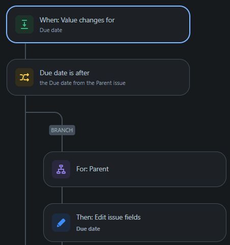

I made an automation that edits the due date of a parent task if its child task's due date is edited to be after the parent task. This way, if a sub task due date is set after the parent task, it automatically makes them the same due date.
I've found that the subtask updates the parent tasks just fine, but not it's "grandparent" Epic parent. Not sure if there is a way to have this loop back and check if the parent task that is updated also has a parent task above its parent that needs updating.
I've tried moving the If Issue fields condition around and seeing if it makes a difference, but I haven't been successful.
Any tips or insights on if this is possible would be appreciated!
