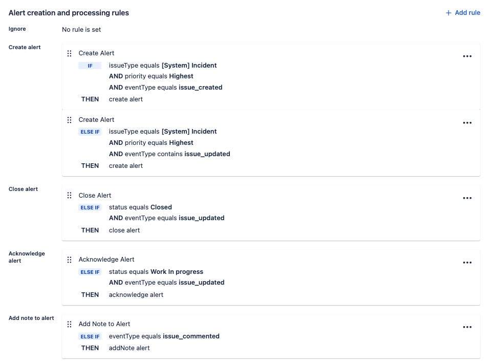

My approach was (demo case):
1. I created a Jira Team “Service Team”
2. created a project sync between my Jira project and the OpsGenie / Operations
However, this only works halfway. In my sync there is a “Create alert” rule, which I have restricted to the priority -> this works.

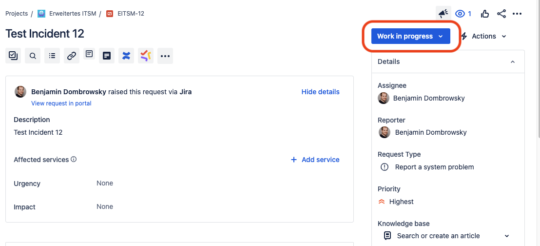

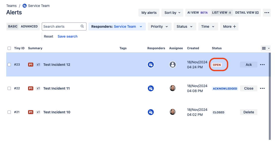

My rules for “Close” and “Acknowledge” do not work and I can't get them to work (both the one that was created in the standard and the one that I customized). The “Add note to alert” rule works again. In other words, a status change has no effect on my alert - I don't see the change in the alert at all. It seems as if the sync is not working at this moment. The other direction then works again, i.e. closing the alert is visible in my process.
Hence my question(s): Am I going the current right way for my requirements and does anyone have an idea why my status changes in Jira do not lead to acklowledge or close my alert?
