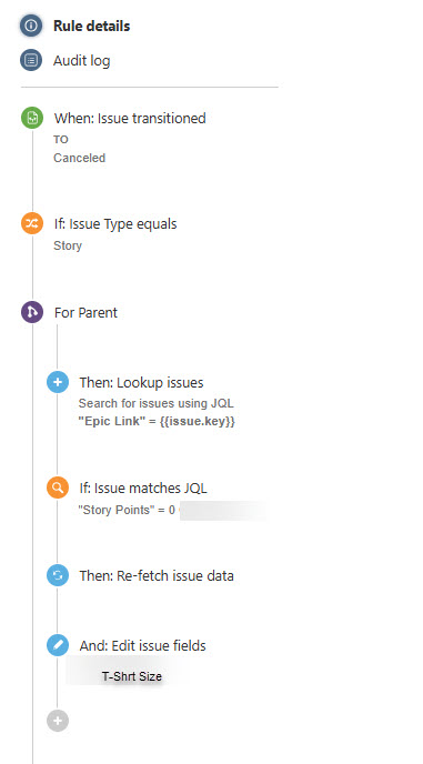

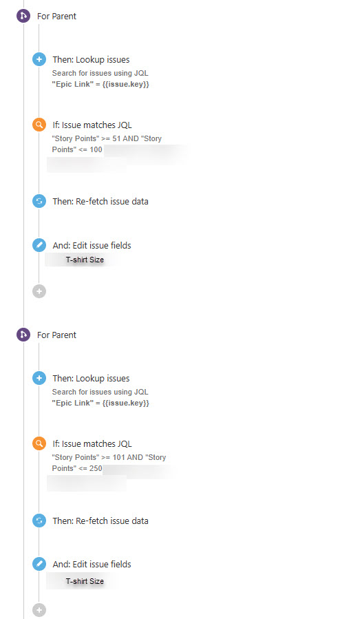

My automation works well as far as the following goes:
- Story Points are summed at an epic level and T-Shirt Size gets set accordingly:
XS = 50 hrs. or less
S = 51-100 hrs.
M = 101-250 hrs.
L = 251-500 hrs.
XL = 501 hrs. or greater
- When Story Points change values - that too rolls up from the story to the epic accordingly.
- When the story transitions to the status of 'Canceled' the story points from the stories get reduced accordingly at an epic level.
Issue is that the T-Shirt size does not get adjusted accordingly after the story is 'Canceled' we only see the summation of the story points get adjusted accordingly, but the T-Shirt size field does not update.
How can I ensure that the T-shirt size field updates appropriately after story points are subtracted at the epic level—specifically when a story with the status 'Canceled' alters the total story points? While the story points are updating accurately, the problem is that the T-shirt size isn't reflecting the change after the summation adjusts due to a 'Canceled' story. The T-Shirt size value just does not update.
This is my automation below, please let me know what I am doing wrong.
