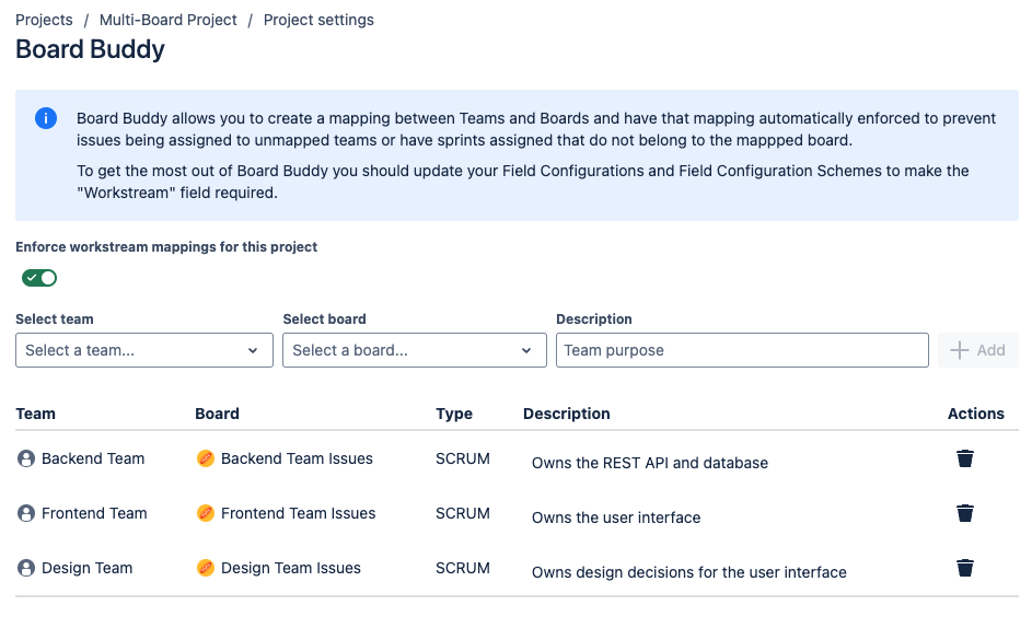

Project the Project Settings page select "Board Buddy" from under the "Apps" expanding section in the sidebar and this takes you to the main mapping configuration screen (shown in the screenshot below):
Once you have created your team to board mappings and enabled “the enforcer” (using the toggle control) you can start to use the “Workstream” field.

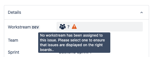

If you already have an existing project that you’re enabling the Board Buddy for then you will have existing issues without the Workstream field set. The field will prompt users to set a value:

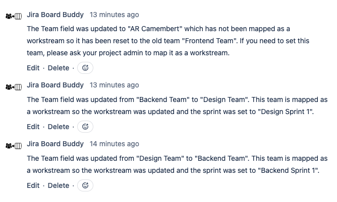

Any change to an issue in the project will trigger the enforcer to check the validity of the team and sprint and automatically correct any errors if it can.

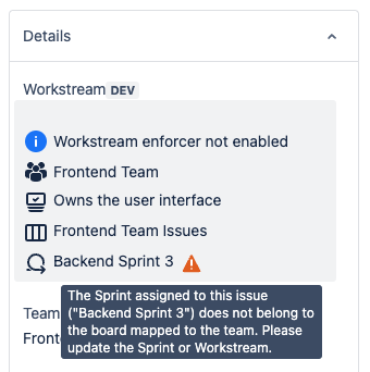

When the enforcer is disabled any invalid sprint or team settings will be highlighted in the issue view:

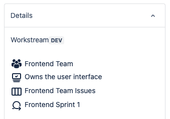

When team and sprint settings are valid the issue view will just show the relevant information:

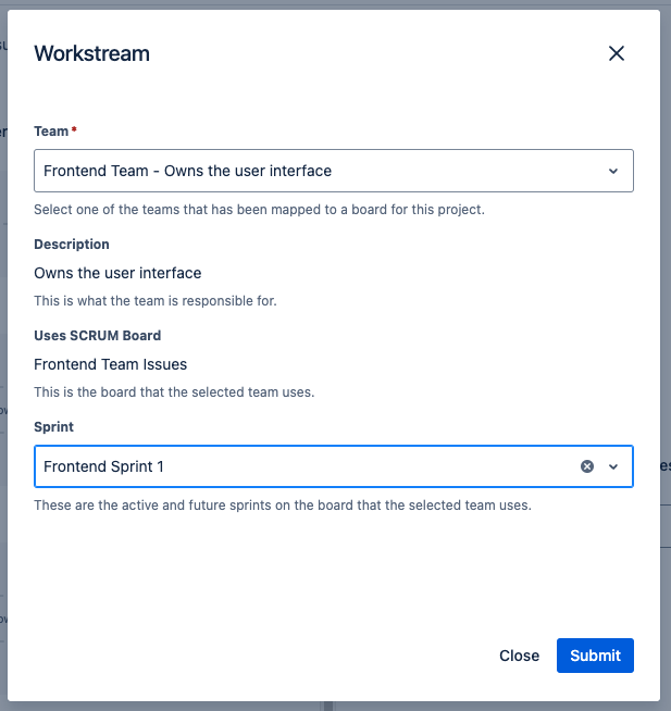

The edit UX is rendered in a modal dialog and allows you to not only select the team but also change the sprint.
