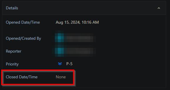

With that, after creating a new issue and viewing it in the issue view, I see my custom field called 'Closed Date/Time' and it is populated with nothing.

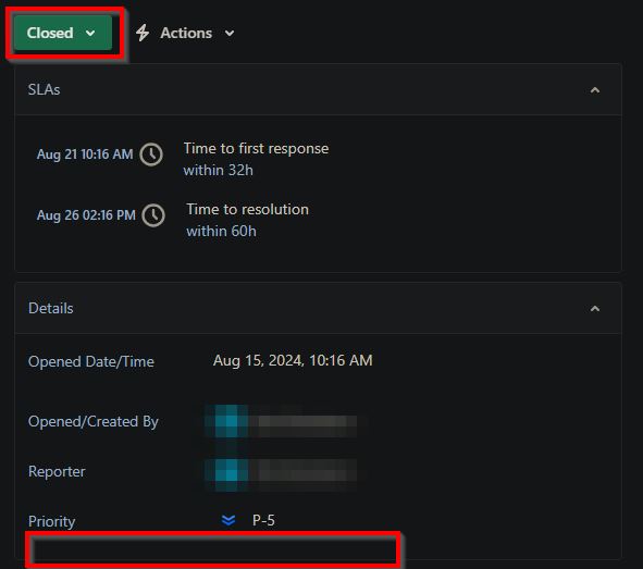

The issue is when I transition the issue to 'Closed'; the 'Closed Date/Time' field just disappears from the issue view.

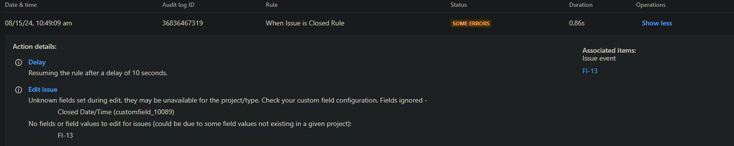

I looked at my automation's audit log and it gives me an Unknown fields during edit error.

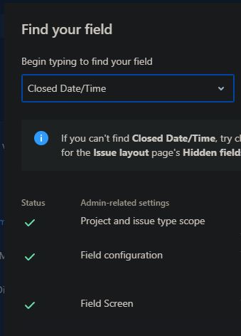

I then used the find your field option in the issue itself and it found my field with no issues.
