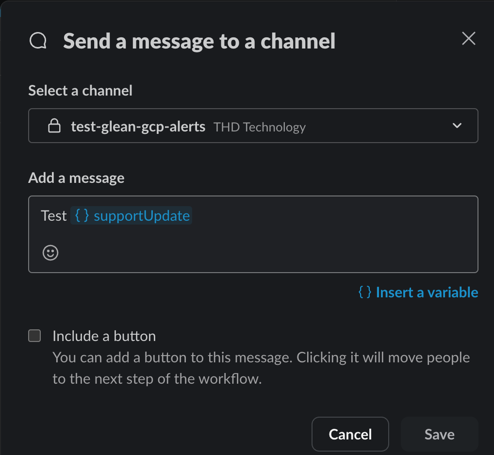

To clarify, the Slack Send a message to a channel step has this as the message:
"Test: {message}", where {message} should be the actual message sent by the Jira automation to the webhook. Instead, the channel only receives "Test: ".

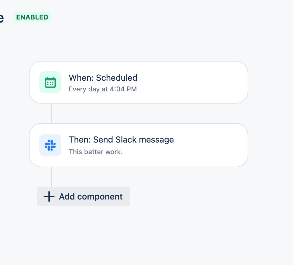

It seems like the Jira "Send Message to Slack Channel" just isn't working properly. To simplify I created the following rule:
That's it. That's the entire rule. At 4:04PM, send a message to this webhook with that message.
The webhook is hit, a message shows up, but the actual content of the "Send Slack message" step is empty. "This better work" should show up, but nothing does.

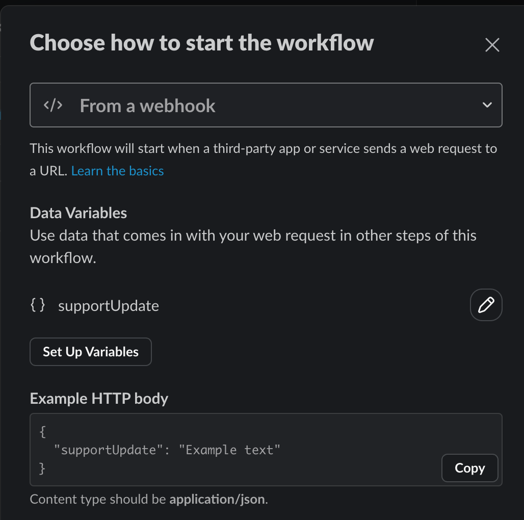

I suspect this might be because of the change in how Slack handles webhooks. All the examples and documentation I could find on the Slack side have no reference to setting up Data Variables, as can be seen in my other screenshots below. But again, if I format a curl request with that data value and hit the webhook it shows up in channel fine. I'm assuming the "Jira Send Slack message" action format just doesn't match the Slack webhook anymore.

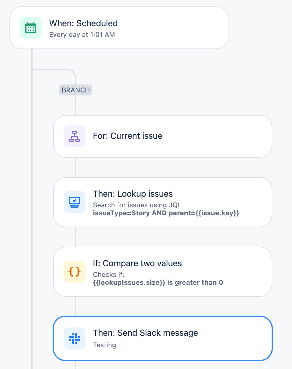

The Jira Rule:
The Slack "Send a Message to a channel" workflow step configuration:
The Slack "Start with a webhook" configuration:

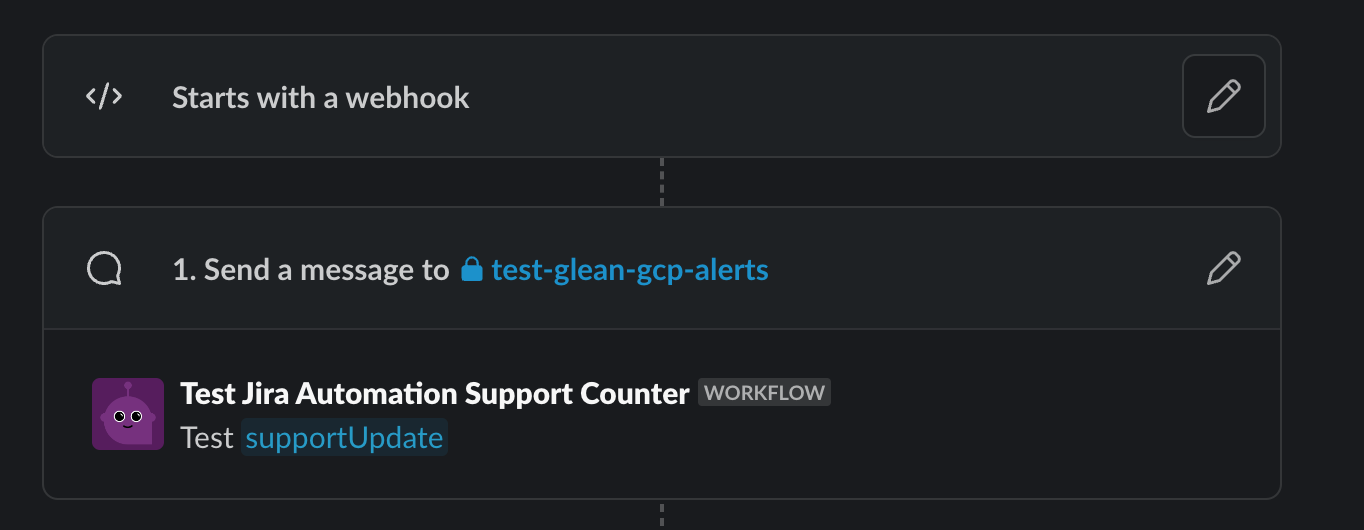

The Slack automation configuration:

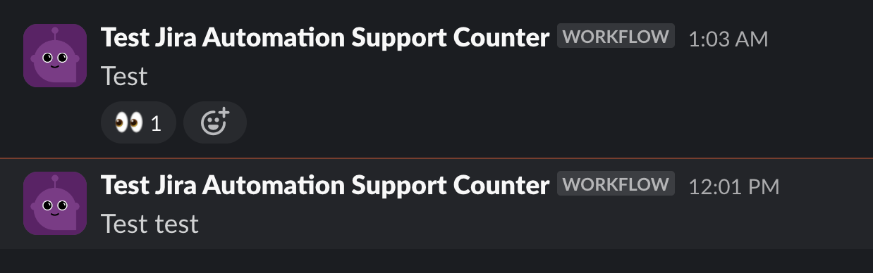

When I curl the webhook the message shows up perfectly. It's only when Jira sends the message that it fails to show up, as seen here (the top message is from Jira, lacking the actual "testing" we should see, the bottom message is from my curl request, and correctly shows the "test" content):
