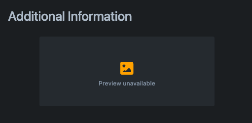

Lately the issue has come back and I am seeting the placeholder icon where images should be, as below.

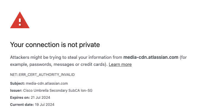

I can see in the network tab that there is a cert error being reported

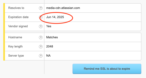

And if I go directly to the URL there it seems the cert is about to expire but I wouldn't have thought that would be a particular issue.
The error seems to be prevalent in Firefox and Chrome latest versions.

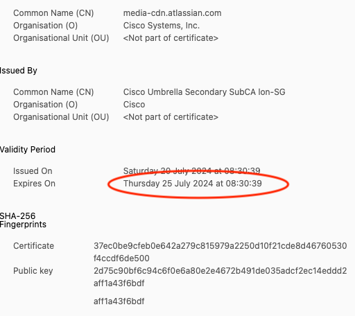

Interestingly perhaps is that when I use sslchecker to verify the cert it reports a different fate to the one in chrome.
Also there is no organisation Unit. I am not sure if that is even important at this point, it seems to not be mandatory.
"Further, what constitutes a valid OU has been vague and arbitrarily defined by different Certificate Authorities (CAs). It has also been the only non-mandatory standard input field in Certificate Signing Requests."
The main observation here is the date which seems odd it should be the same, in which case how can it be different. And it is still a valid date so the CERT should be fine.
