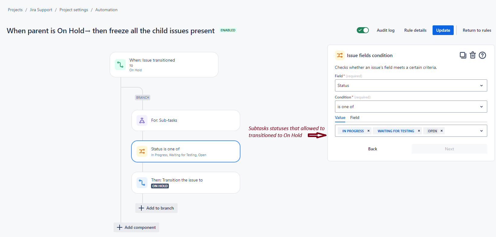

I need help setting up an automation rule that transitions all sub-tasks to On Hold whenever their parent issue is transitioned to "On Hold," as long as these sub-tasks are not already in "On Hold" or "Done" statuses.

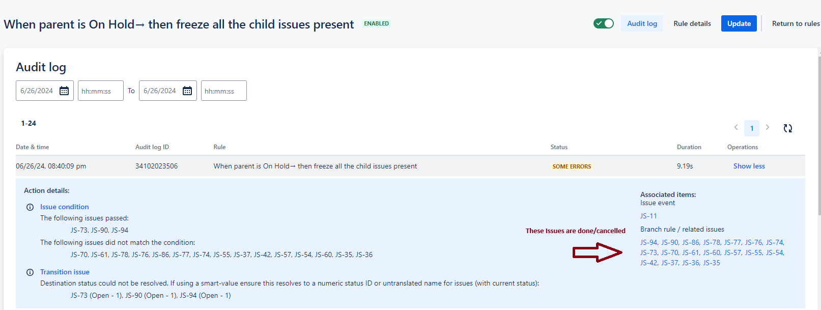

Currently, if there is at least one sub-task that is not in the relevant statuses I've specified, the rule is blocked. However, the automation should only transition sub-tasks that are not "Done" or already "On Hold."
In the other hand, when I removed the issue field condition, the automation worked fine, and transitioned each and every subtask to On Hold, even if it was Done.
Automation Rule:
Audit Log:
