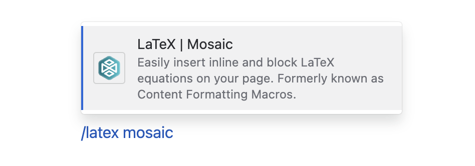

1️⃣ LaTeX Math Macro for Confluence - a standalone LaTeX macro that adds LaTeX formatting to Confluence.
2️⃣ Mosaic for Confluence - a complete macro toolkit that includes LaTeX for Confluence plus other formatting features such as Tabs, Numbered Headings, Footnotes, Tooltips, etc.

1. On your Confluence page, click the pencil icon in the top-right to edit the page.
2. Type “/latex” where you’d like to add your macro, then select it from the dropdown menu.

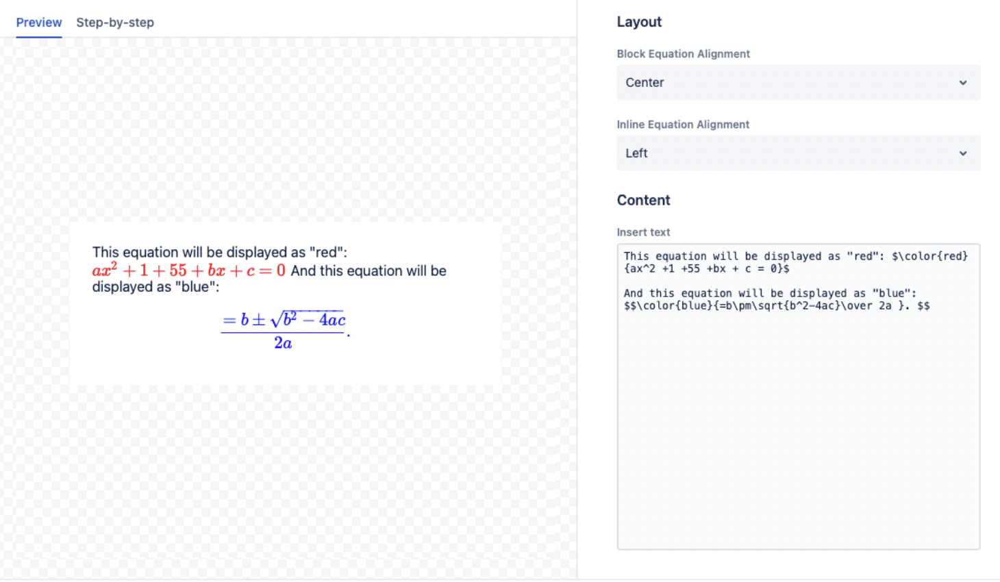

Display as block (separate from other text): Two dollar signs ($$) on each side of the text
For example:
$$x = {-b \pm \sqrt{b^2-4ac} \over 2a}$$
Here you can see the difference, with inline formatting on the same line as the text, but with block formatting on another line:

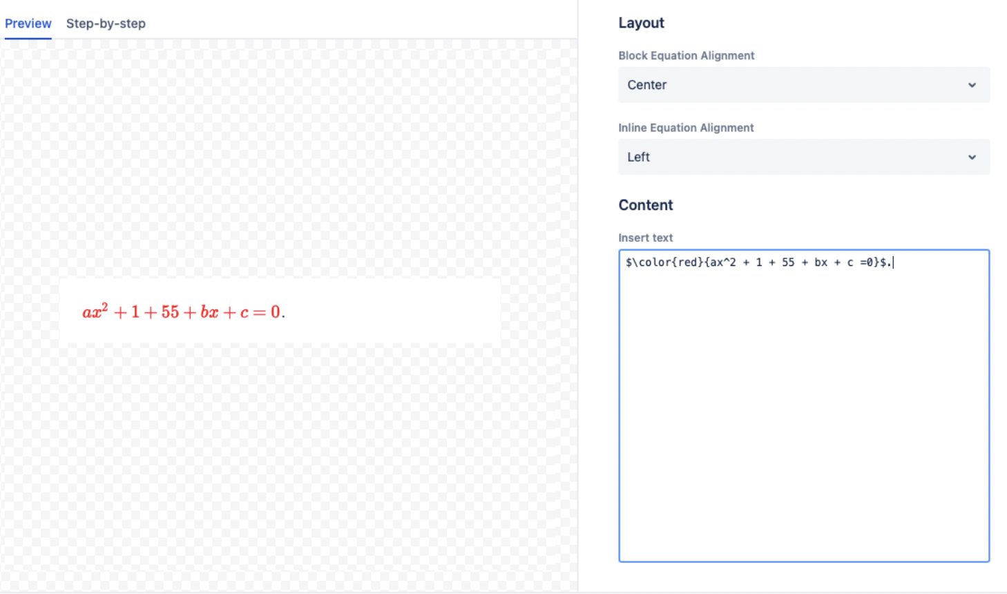

Add colour: Add “\color{your_color}” to the beginning of your formula.
For example:
$\color{red}{ax^2 + 1 + 55 + bx + c =0}$
Creates:

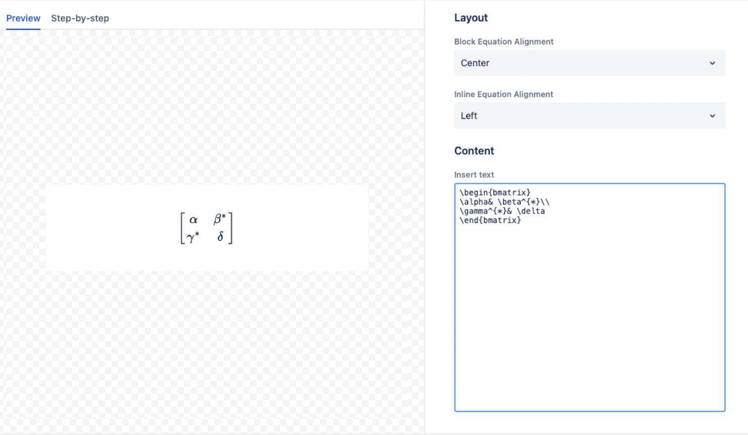

Format as a matrix (display numbers/symbols in rows and columns within square brackets):
Use \begin{matrix} at the beginning of the matrix
Add an ampersand (&) to add an extra column to your row
Add two forward slashes (\\) at the end of your row to add a new row
Use \end{bmatrix} at the end
For example:
\begin{bmatrix}
\alpha& \beta^{*}\\
\gamma^{*}& \delta
\end{bmatrix}
Creates:

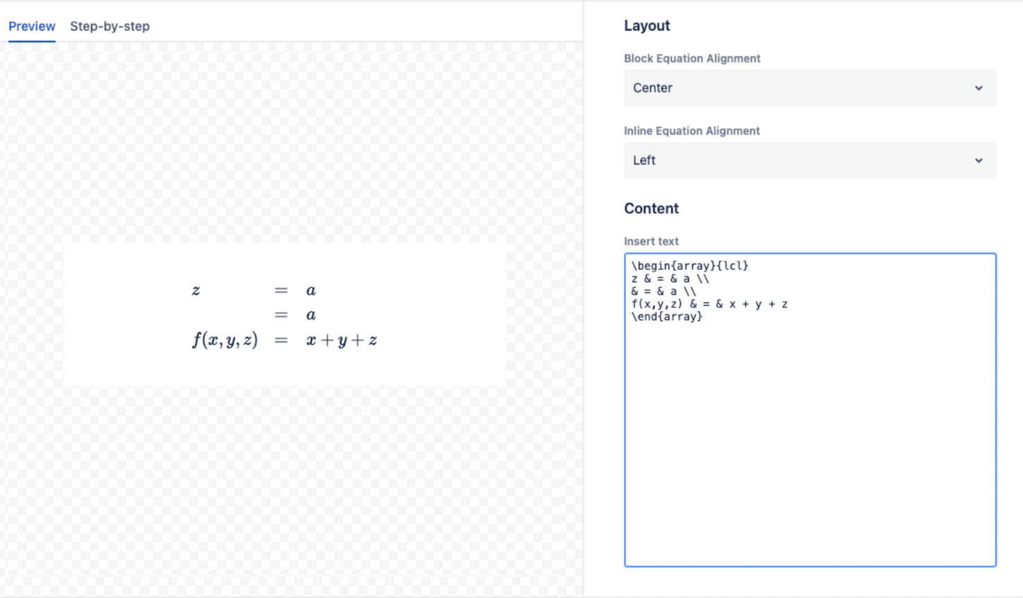

Format as an array (format equations in a table with each column independently aligned):
Use \begin{array}{lcl} at the beginning of the array
Add an ampersand (&) to skip/move to the next column in your table
For example:
\begin{array}{lcl}
z & = & a \\
& = & a \\
f(x,y,z) & = & x + y + z
\end{array}
Creates:
