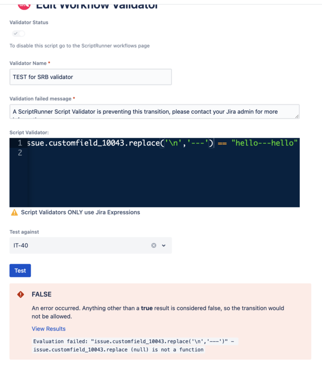

1. Example of a workflow validator failure
Script
issue.customfield_10043.replace("\n", "---") == "hello---hello"

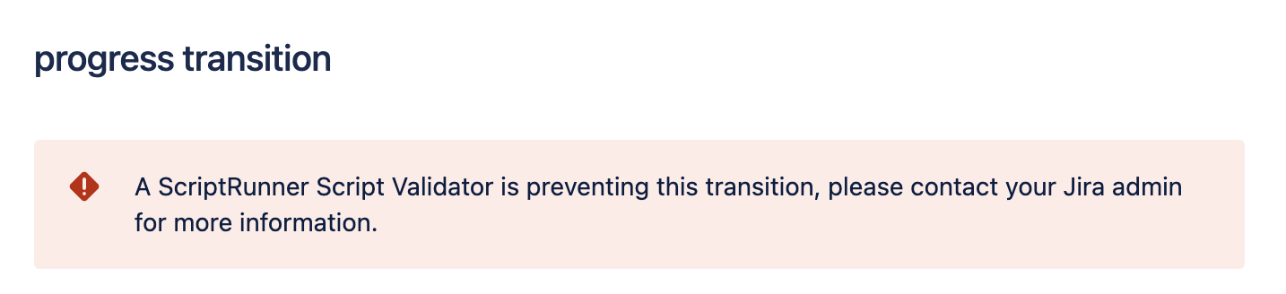

Below is an example of the workflow error when reproducing this issue.
The error message below will display on the transition screen.

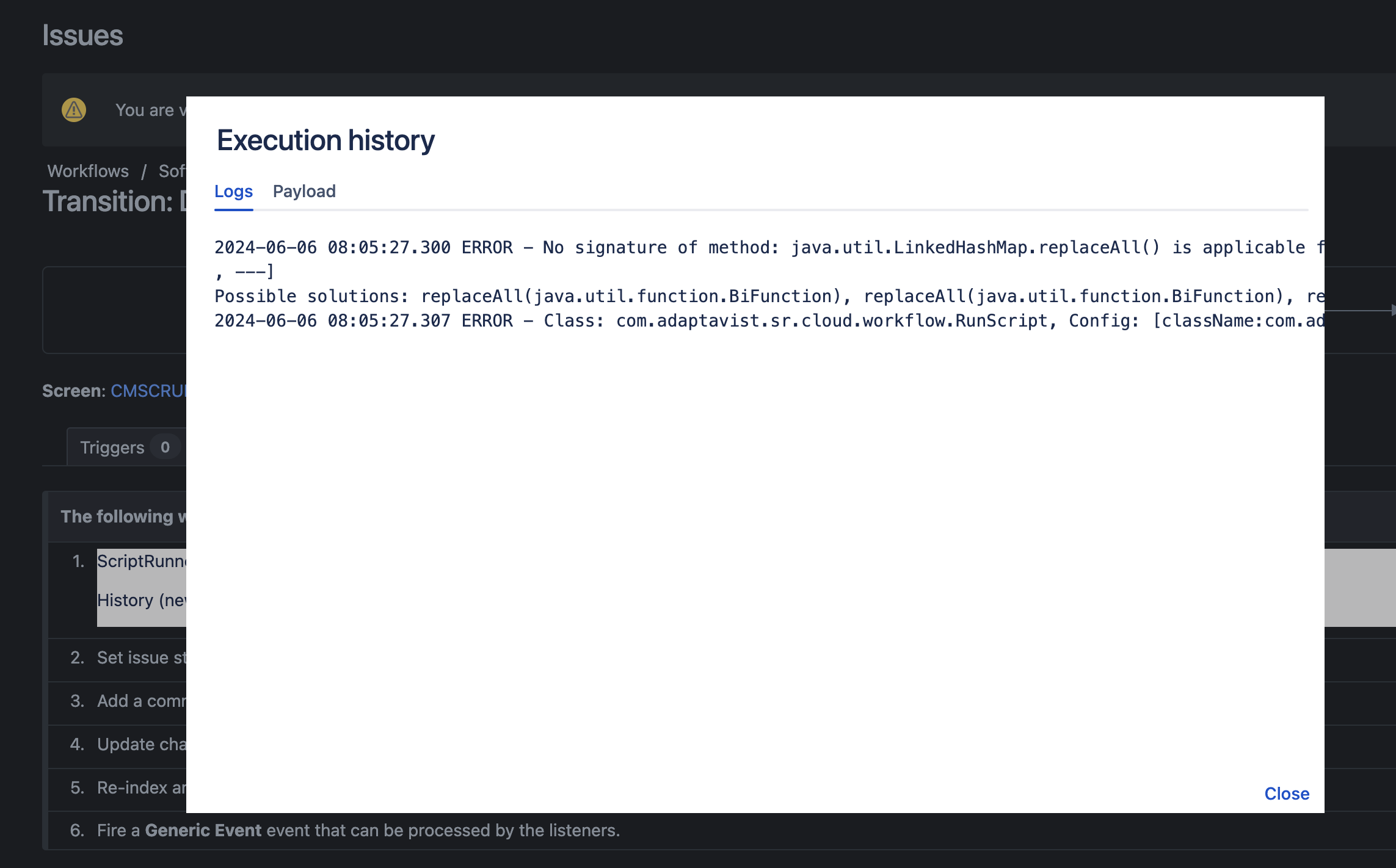

issue.fields.customfield_10033.replaceAll("\n", "---") == "hello---hello"

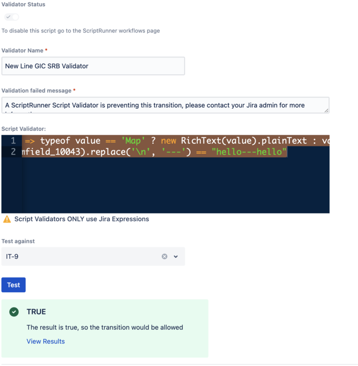

1. Example of a functional solution for workflow validator
let plainTextValue = value => typeof value == 'Map' ? new RichText(value).plainText : value ;
plainTextValue(issue.customfield_10043).replace('\n', '---') == "hello---hello"
You can update and test the above script.

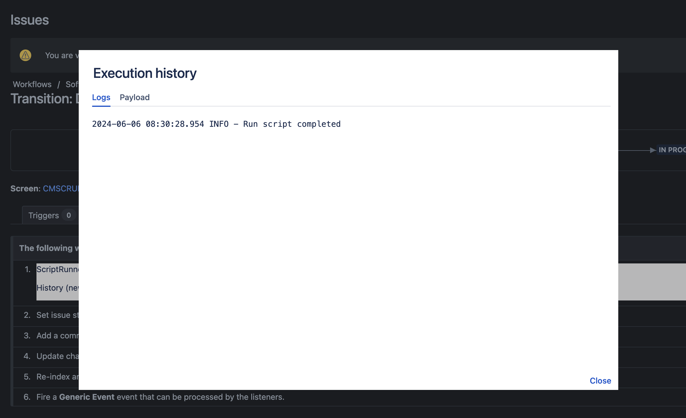

2. Example of a functional solution for post functions
Object value = issue.fields.customfield_10033
String plainTextValue = value instanceof LinkedHashMap ? value.get("content").get(0).get("content").get(0).get("text") : value ;
plainTextValue.replaceAll("\n","---") == "hello---hello"
Post the changes made, save the runner, and you should be able to execute the transition successfully. To test this on the new experience, you can request access to join the early access program and reference this post.
