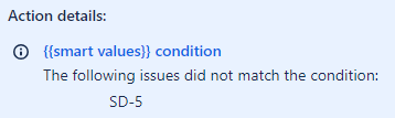

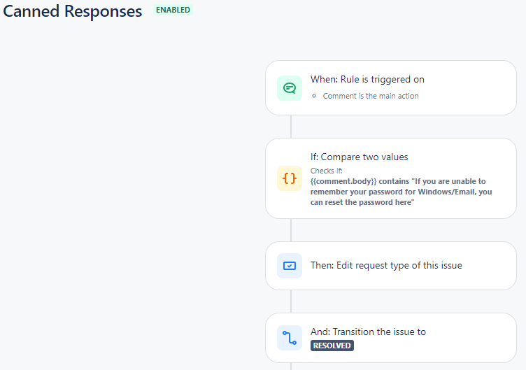

I am attempting to set up an automation so that when a specific canned response is used, it updates the request type and closes the ticket (for simple tasks like password reset links, etc) but my rule will run and do nothing. I've looked at a few other similar issues in the community but so far I've had no luck with those suggestions.
The comment from the canned response contains the exact phrase that I have the automation set to recognize so I am assuming I am missing something simple to get it to recognize it (change smart value condition, etc.)
I've tried {{comment.body}}, {{comment}}, {{issue.comment}} and also changing the rule to run for all comments added and not just the main action but no dice. I've also swapped my condition between contains, contains regular expression, and equals but that made no difference either.
