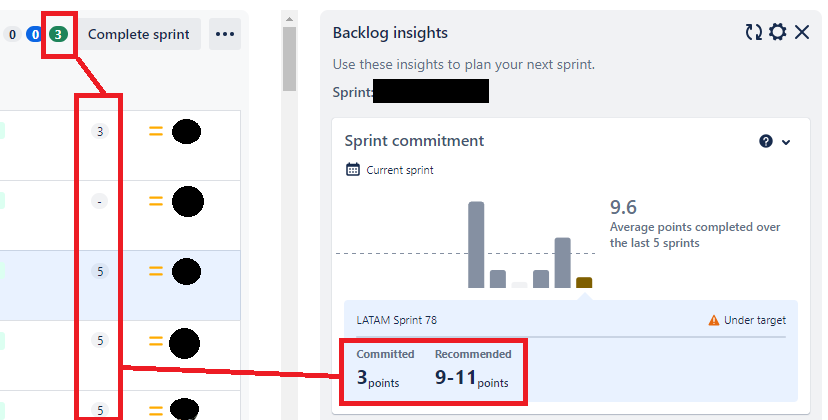

The problem of switching to Subtasks is that now the tab Insights is not working properly neither in the Backlog nor in the Active Sprint.
As you can see below, our current Sprint is only being considered to have a total of 3 points, despite lots of points in the Sprint Backlog. (The 3 counted points are from a Bug, not a Subtask). This is a problem for Sprint Planning as now the points from Subtasks needs to be summed manually by the team, as well as the Sprint commitment chart is already completely wrong as it is not summing the points correctly.

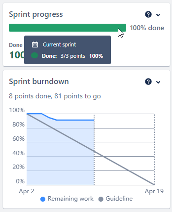

And if you check the Insights in the Active Sprint, the Sprint burndown considers the points correctly, but the Sprint progress presents the same bug as above.
