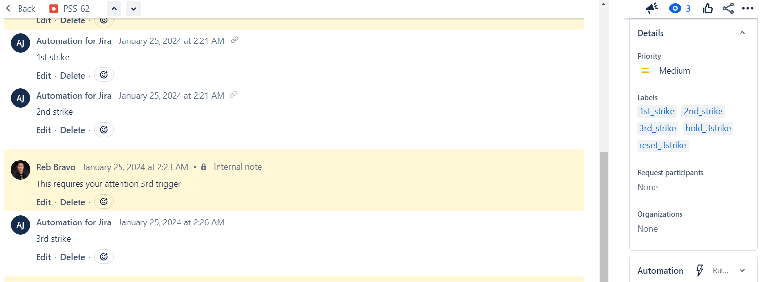

We are currently making a 3-strike rule automation using JIRA we have successfully created the first 3-strike notification. The rule condition is that if the ticket has been assigned to the Waiting for customer status, it will add a comment on the ticket and add a label corresponding to the strike.
- 1st strike - 7 days
- 2nd strike - 14 days
- 3rds strike - 21 days
- Ticket Closure - 22 days (add 24 hrs from the last notification)
Once the customer replies then a label will be added to the ticket "reset_3strike" which will trigger the loop we created.

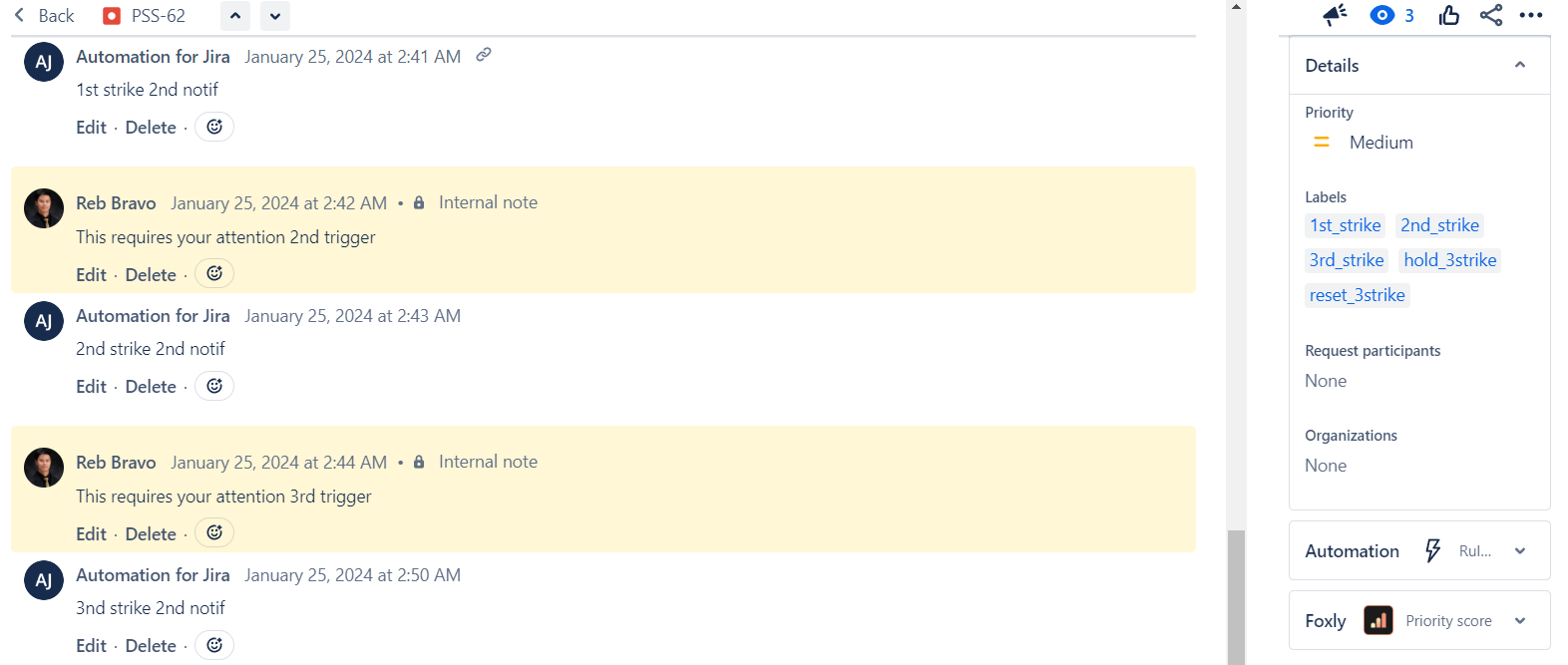

We added a loop by creating another automation with different comment. (Please take note that we ticked the "Prevent duplicates by only adding this comment once to a particular issue.")
We would like to know if there is a way we could loop the notification for the 3 strike rule without creating an additional automation. For example if the automation reads the "reset_3strike" label it will run the 3-strike automation again and will comment the same notification again although there is already a similar comment on the ticket.
We have tried to un-tick the Prevent duplicates and it flooded the ticket with multiple comments.
