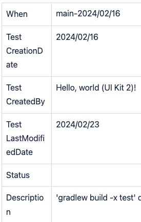

A single Standalone page: Macros work fine (first 4 rows)

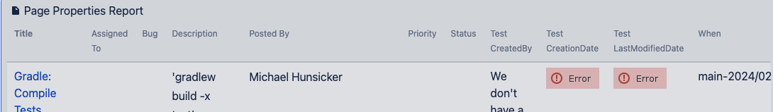

Errors:
As you saw above, the macros work fine in any standalone page, but displays error in the Page Properties Report (see the image below).
There are 3 things happening in the image above.
1.The first error occurred in the 'Test CreatedBy' column, where the 'we don't have a way to export this macro' error was encountered due to the usage of UI Kit 2. Interestingly, the macro works fine and displays the value 'Hello World (UI Kit 2)' on standalone pages.
2.The second issue arises with errors in the TestCreationDate and TestLastModifiedDate columns, both utilizing Forge macros with UI Kit. While these macros function correctly on standalone pages, they fail to display properly within the Page Properties Report.

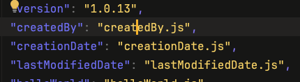

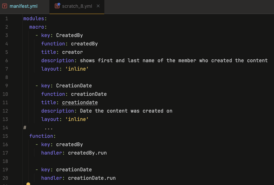

I've developed three separate components in three different JSX files and specified them in the manifest.yml file. To insert these macros into pages, I use a forward slash followed by the macro name or title. This allows the page to display the values generated by these macros..
3. This is an interesting discovery: none of the approaches worked within the Page Properties Report Macro except for this specific method. By copying the code from creationDate.jsx and pasting it into the index.jsx file, the macro successfully displays values both on standalone pages and within the Page Properties Report Macro..
