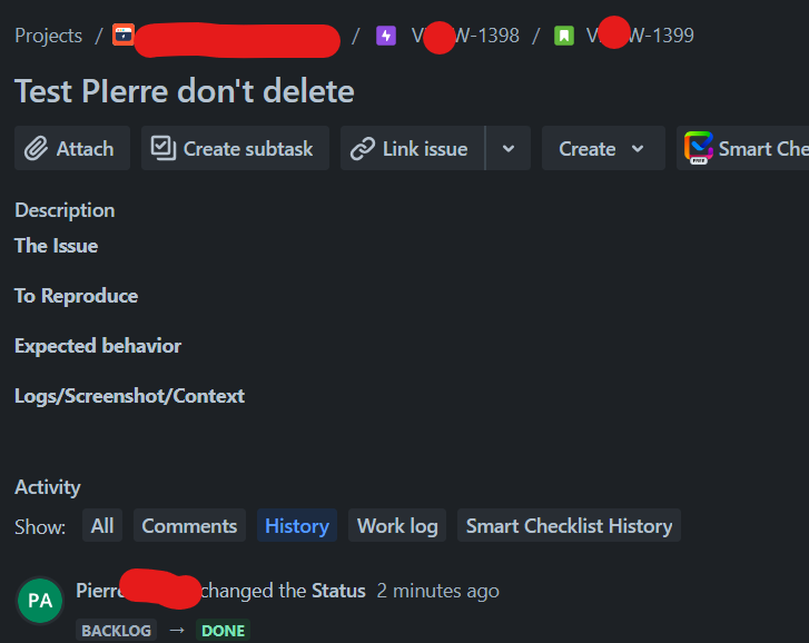

Story : I changed the status

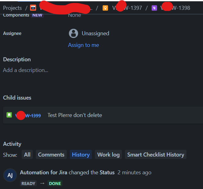

Epic : Automation is ok

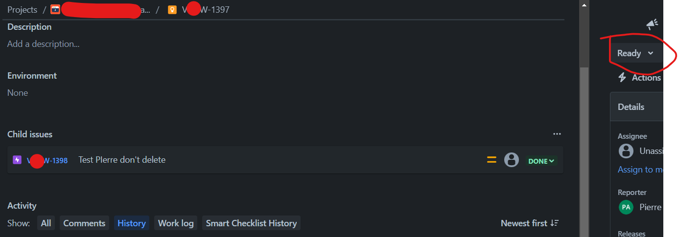

Objective : hasn't changed
Again if I do the manual transition on the Epic, the Objective will change.

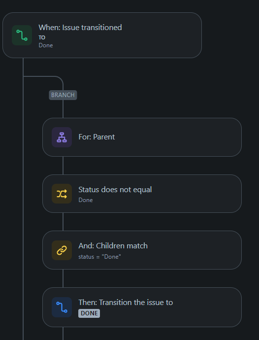

Here is my automation, quite simple for now, but I'm ok to add more steps if needed, to chain actions and automations
