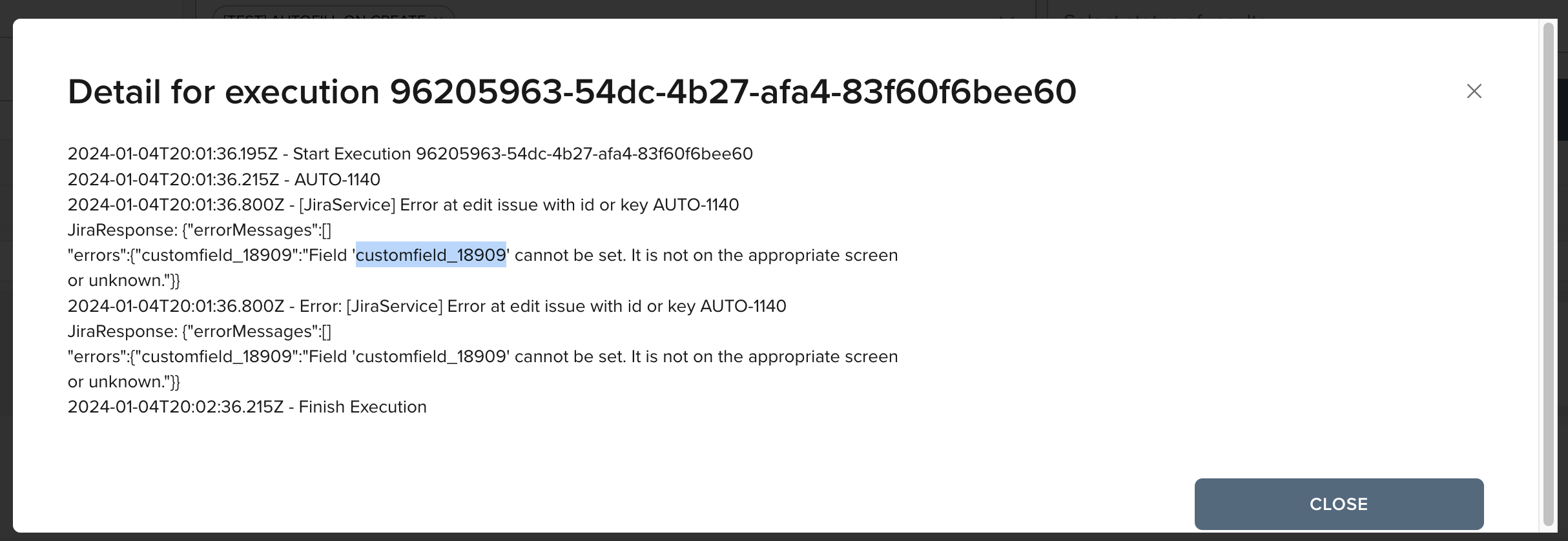

We are doing an integration outside of jira automation, because we are having performance problems in our instance.
This automation consists of copying some attributes from the assets to custom jira fields, due to the issue of exporting and not bringing the values.
But these fields that need to be filled in by this automation are only on the preview screen, because they can't be edited and we run the risk of losing the original information.
But when we run this script, it returns an error because these fields are not on the editing screen.
Do you know how we can solve this?
Note: The user we are using has admin permission for the instance and not org.
