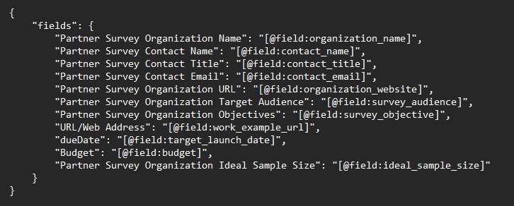

Caspio Webhook Custom Payload:

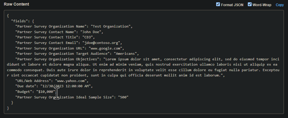

Result of Webhook Payload: This screenshot was from one of my early tests. This proves that the correct data is being pulled from Caspio and sent along in the payload. I know I will have an issue with the dueDate field as the data isn't formatted correctly. That's a 'future DQ problem'.

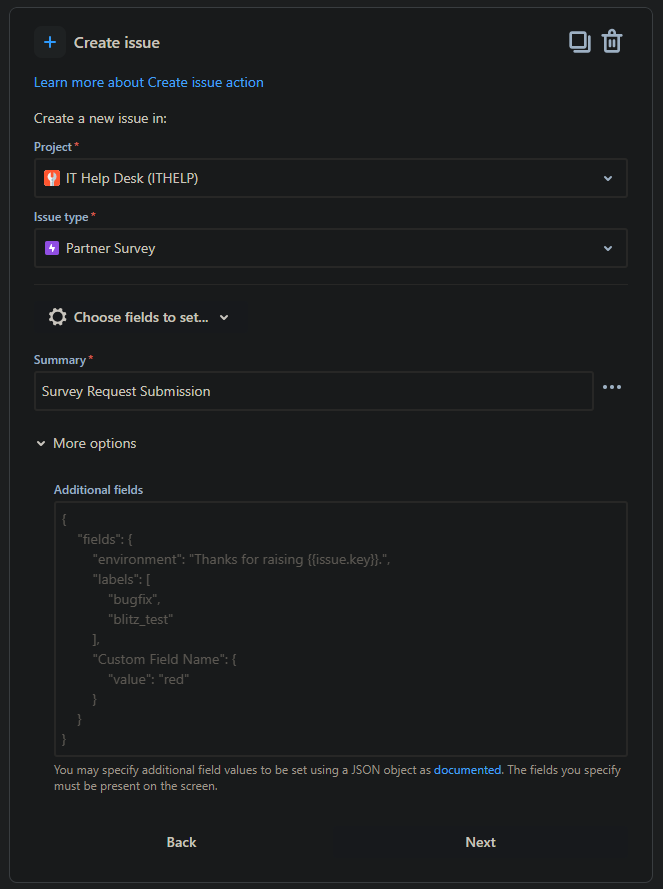

JSM Automation:
I'm showing the 'Additional Fields' section to show I don't have anything in it. Given that my previous tests of this configuration will create an issue, but not put data in the fields, I'm going make a wild assumption that we need to use the 'Additional Fields' section?
Is this were we would use the {{webhookData}} smart value? If so how?
