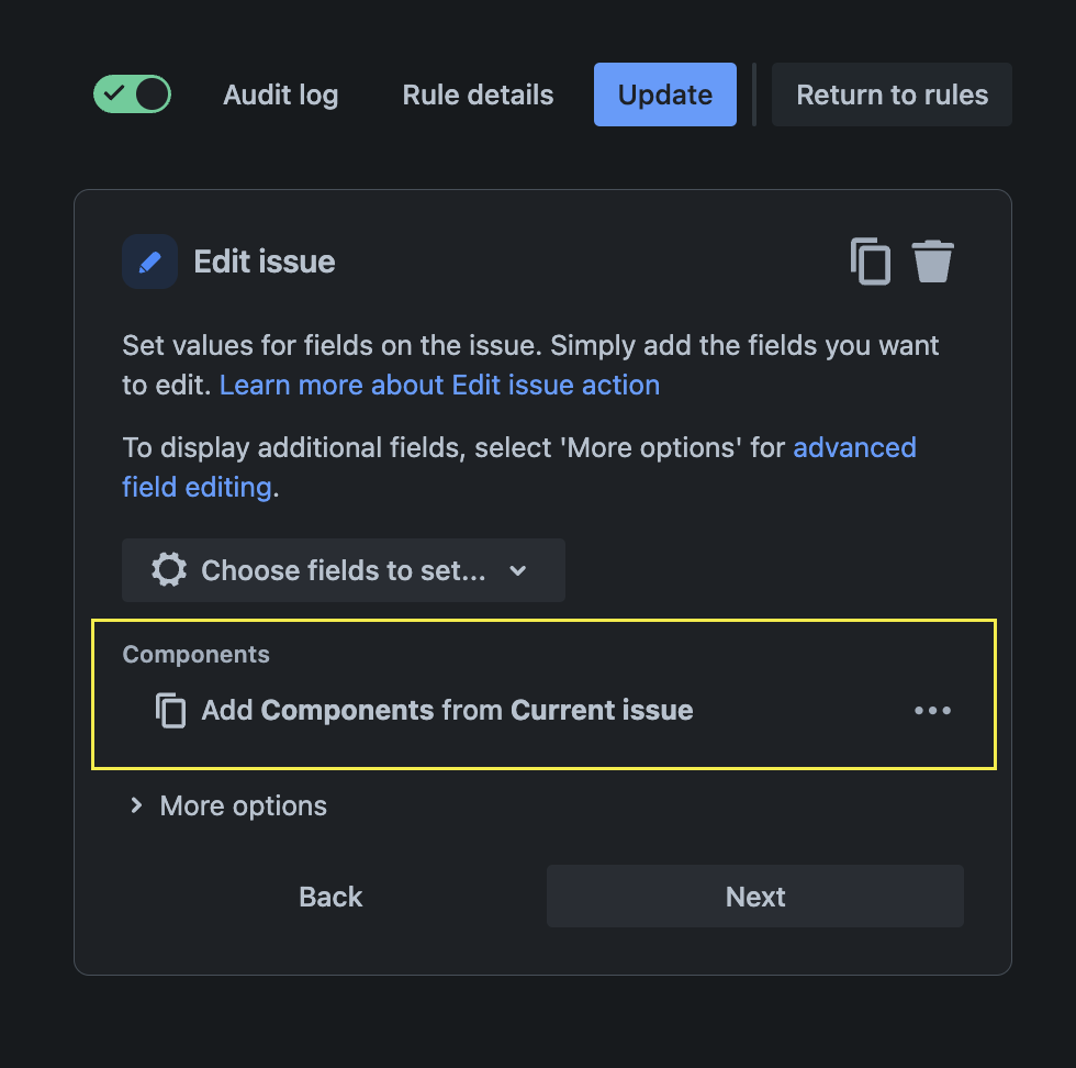

I want the epic's component to be added to the issue's component list, not overwrite any other components the issue was already tagged with upon creation. The documentation has steps for this, called "adding values to multi-select fields." It should work in theory, but I don't have the ability to do what the instructions say.
Instead, in my version of Jira, if I use the "copy from issue" function (called "Add components from current issue"), I lose the ability to add anything else to the field. So I can't add a second component like the instructions state I should be able to. Screenshot attached of what I see.

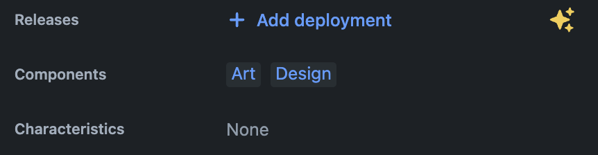

I had an inkling it had to do with how our Components field itself was set-up, but it's already set up to be a multi-select, here is how a ticket I have is tagged:
