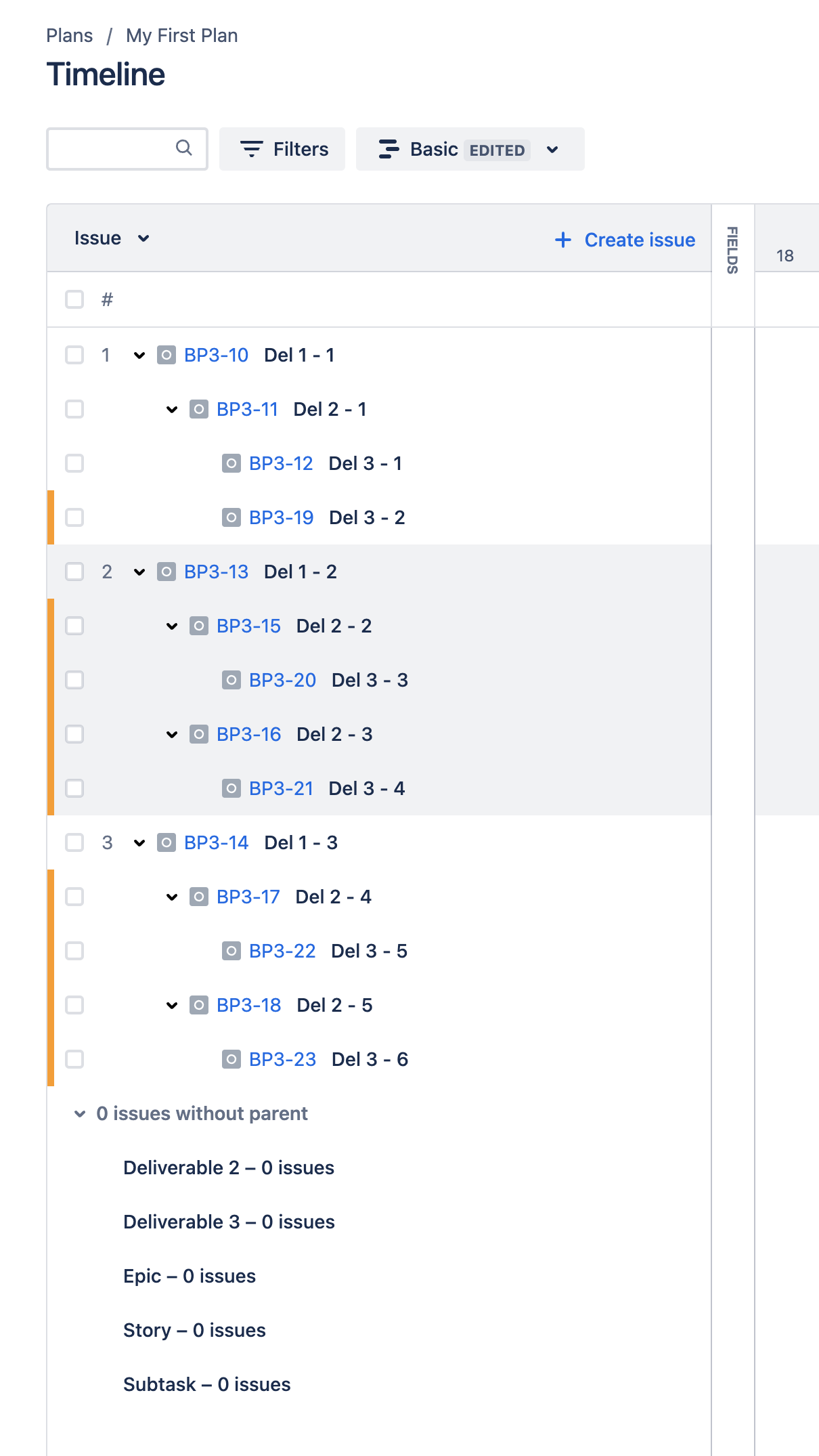

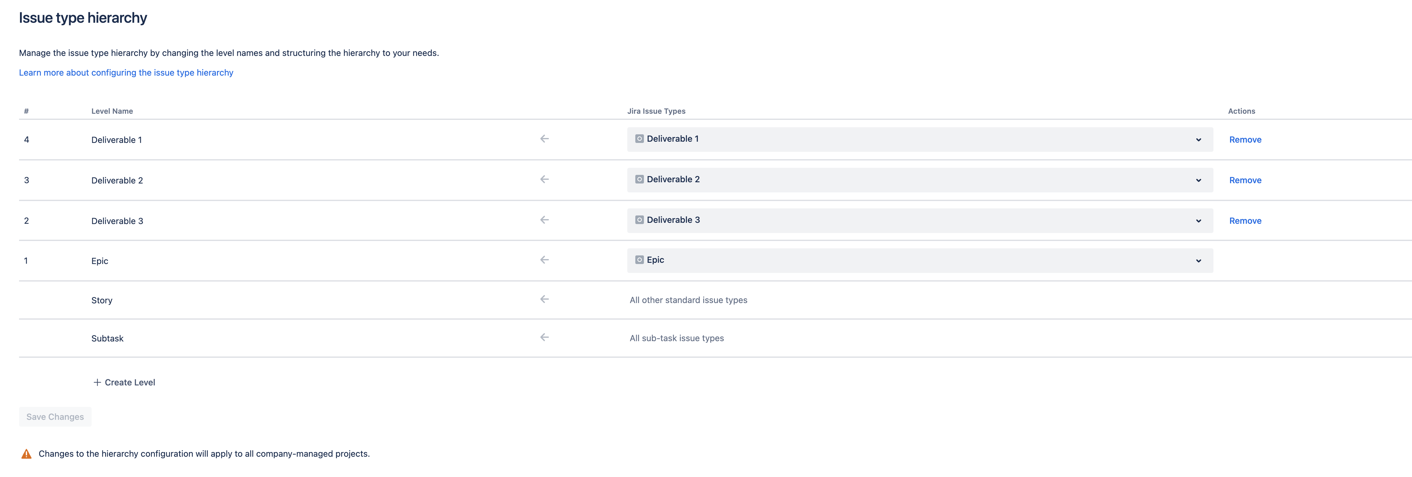

I have a project called "Base Project 3" which defines a custom issue hierarchy above the epic. For reference, the issue hierarchy is "Deliverable 1" -> "Deliverable 2" -> "Deliverable 3".
I have added some issues in the project and configured the parents as applicable. The issues are named to indicate their issue type. Here's how the base project looks like in Advanced Roadmaps:

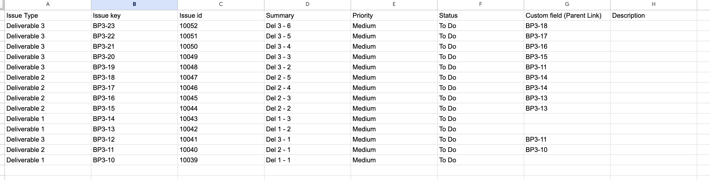

I exported this project to CSV with some selected fields, and it looks like this:

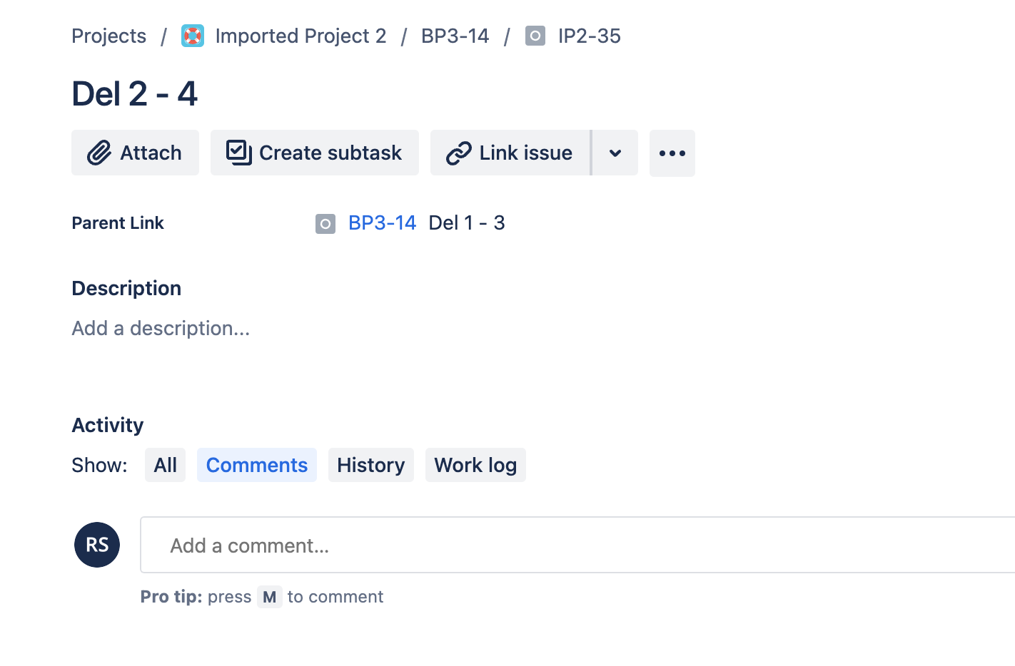

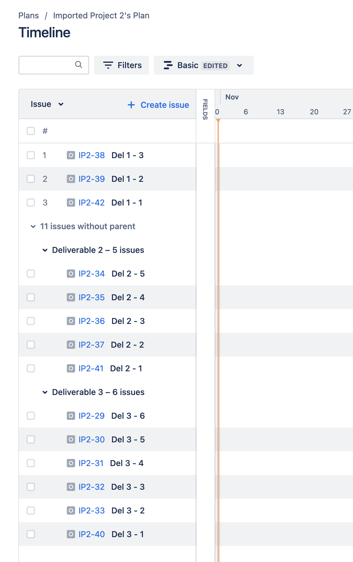

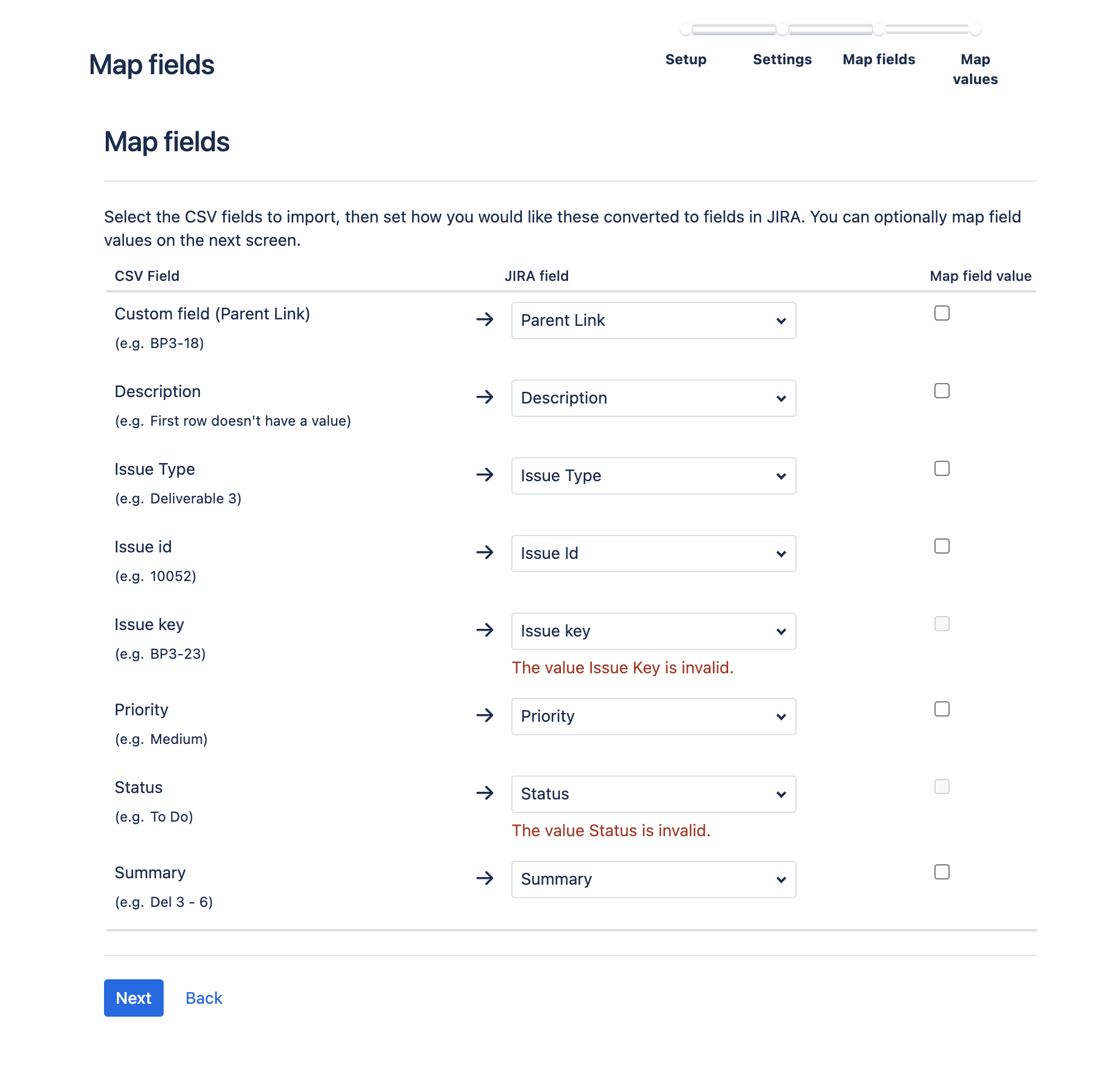

I want to import the CSV exported above into a new project, called "Imported Project 2". I first created the project, and configured it to use the same issue type scheme. When I went ahead and imported it, I could not map the "Custom Field (Parent Link)" and "Issue Key" fields for some reason.
All the issues get imported with the correct issue types, but the parents are not set correctly. Instead, the issues map their parent issues to "Base Project 3".
