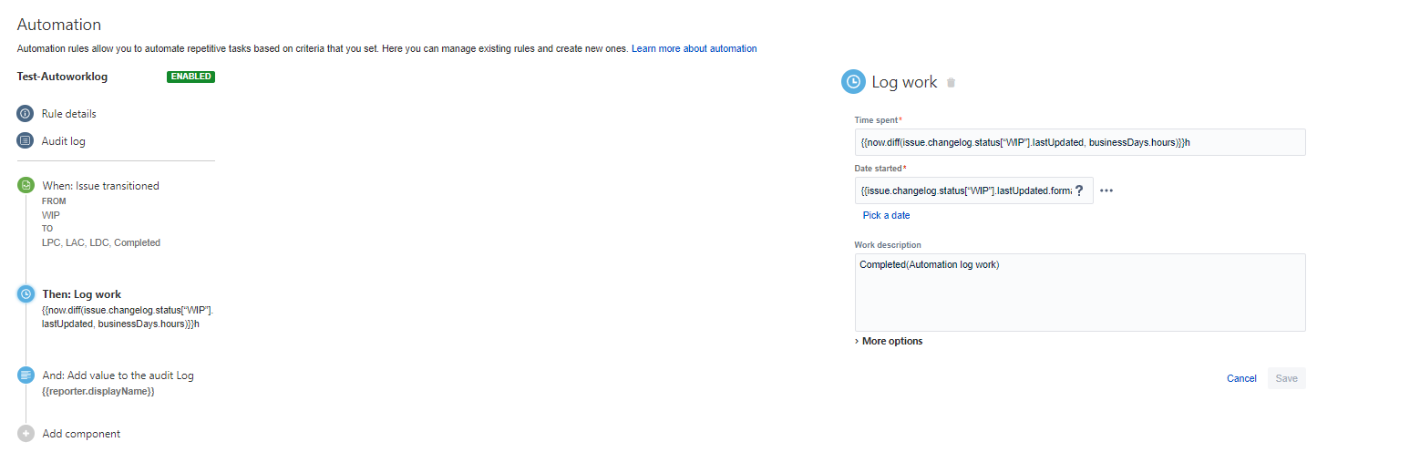

I plan to use the Log work module in Automation to automatically calculate the work time between when an issue is transitioned (Issue transitioned).
My Automation uses
[When:Issue transitioned]→[Log work]
In Logwork, I use smart values to fill in the Time Spent and Date Started parameters as follows:
Time Spent:{{now.diff(issue.changelog.status[“WIP”].lastUpdated, businessDays.hours)}}h
Date Started:{{issue.changelog.status[“WIP”].lastUpdated.format(“dd/MMM/yy h:mm a”)}}
The main purpose is to calculate the work time from the last update to WIP status to the trigger of Automation as Time Spent. And set the last update to WIP status as Date Started.

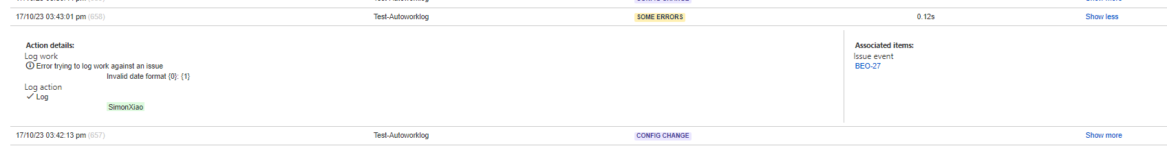

However, an error occurred during execution, as shown in the figure:
