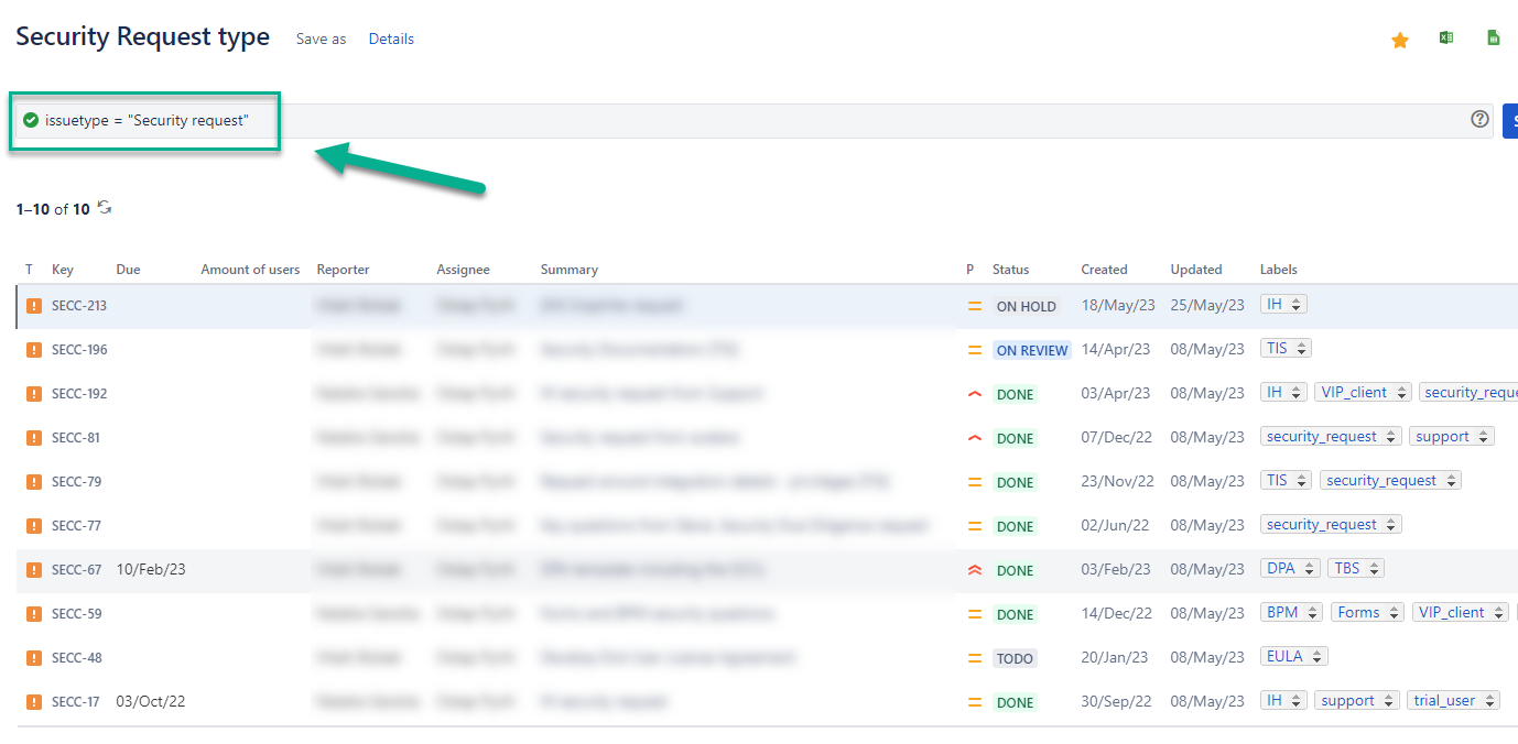

1. We make a task filter with JQL: issuetype = "Security request"

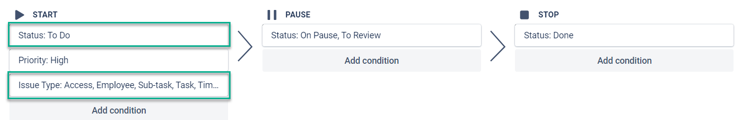

2. We create SLAs for each priority. For example, to close the task in 8 hours, if Priority= High, the conditions will be as follows:
Start
Priority: High
Issue Type: Security request
Pause
Status: On hold
Stop
Status: Done

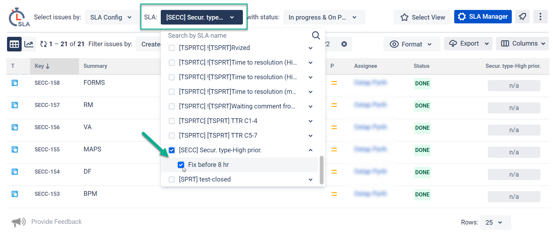

3. Here, is still possible to choose what is more necessary or add 2-3 more SLA configs for different statuses and then add these created SLAs to the report table.
*eventually, we changed it to our current conditions:
If there is a Priority table, it is possible to focus on the time limits for each of them - Highest, High, Normal, Medium, Low, etc.
Created 1 SLA for the test, added there:
Highest = 2 hours
High = 4 hours
Normal = 8 hours
Medium = 24 hours i.e.
Then we go to the report table and select the created SLA. Everything works!
