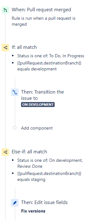

Here is a very common scenario:
If a pull request is merged I would like to transition all issues mentioned in the pull request to a new status, set the fix version and afterwards release the version,

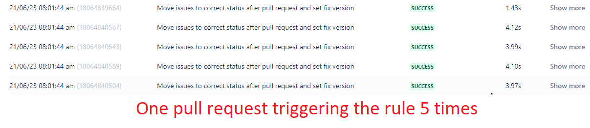

This automation rule is triggered once for each referenced issue. All issues are tagged with the correct fix version and are transitioned to done, this part is working fine.

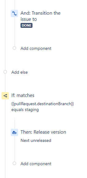

My problem is that after this rule has completed I would like to release the version automatically, If I add a new block at the end like shown above it will attempt to release the version for each issue that triggered the rule.
Question: How can I transition all issues in a pull request and just have it trigger the release version just one time for the pull request after the above automation has completed?
