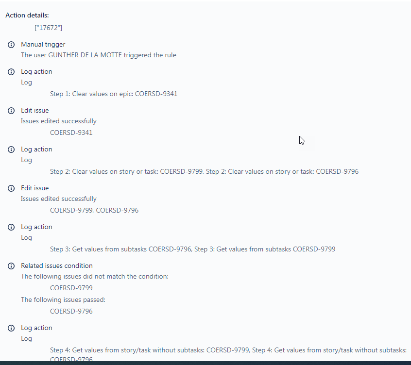

This last step doesn't work. In order to find the root cause, I added a Log Action, in order to see if the different steps are correctly executed.

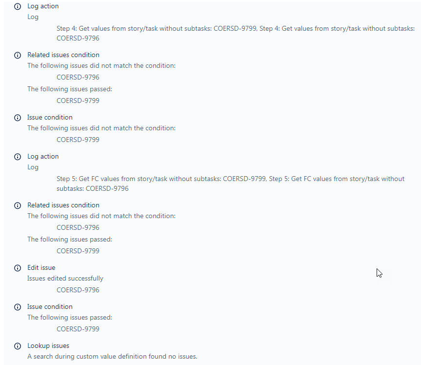

As you can see in the screen shots below, the action log Steps 1 - 5 are correctly executed in the sequence of my automation:

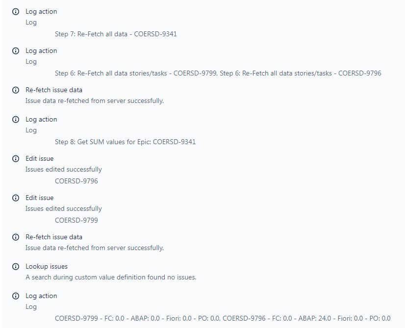

As from step 6 the sequence is no longer correct, step 7 is firs then step 6 then step 8:
As last action log, you see the sum of the different custom fields based on a lookup issues. Which shows me incorrect values.

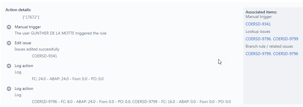

When we execute this last step with another automation rule which is only taking the sum of the custom values, we see that it is working fine:
