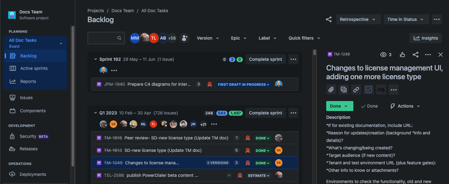

One of their active sprints is open but has not been completed yet, so it’s still active even though it’s past its ‘due date’.
In the Backlog, this sprint shows many issues that are in “Done” status. The team only uses one status (“Done”) to indicate completion in their workflow, and that status is mapped to the far-right column on the scrum board.

Done issues with Resolution set in active sprint backlog:

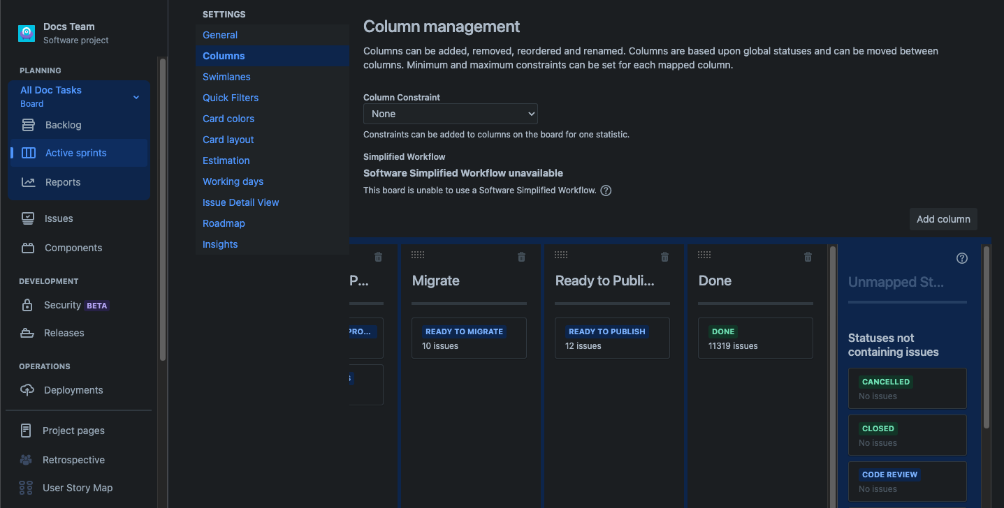

Board settings showing Done status mapped to far-right column:
