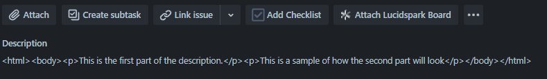

This is how the Description field looks when the issue is created:

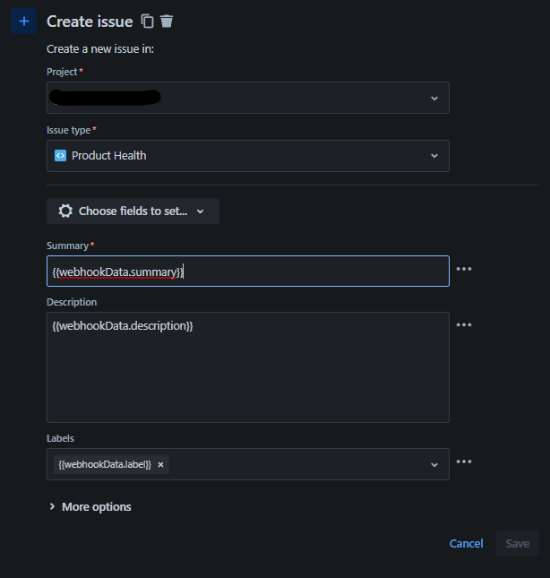

The automation rule is setup as follows:
I've tried adding ".html" within the "{{webhookData.description}} smart value, but that just causes the description to be blank when the issue is created.
