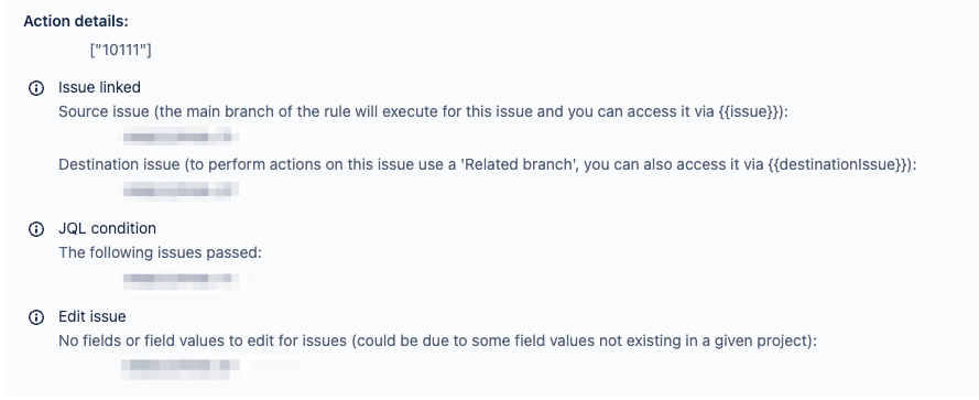

I'm sure this could be achieved through simple automation, but when I look at my audit logs the trigger issue is the created Test. Which isn't an issue until I try to get the Epic Link of the "tests" which I can't figure out how to get.
I've added a ss of my audit log because I've been continuously tweaking my trigger conditions and I'm getting the same result. Any ideas on how I can achieve the above? Thank you!
